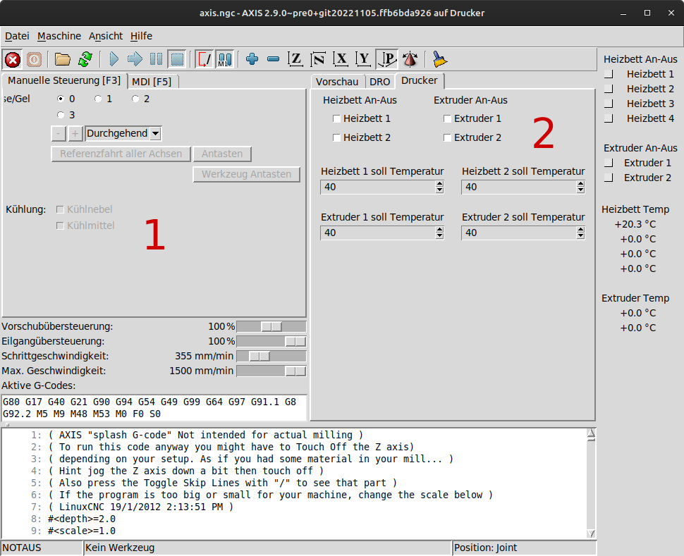

I'm wondering if there is a way to reset pins when E-Stop is pressed.
1) It should work the way as the coolant pins on axis are working. When E-Stop is pressed they are not only disabled they even get switched off.
2) I would like to have the pins on my page to work in a similar way.
Is it possible to do that in some way?

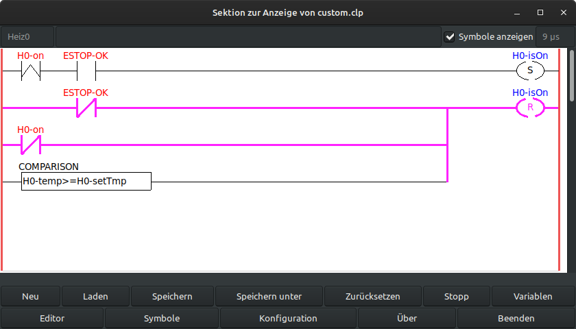

Ok understood. The only way is to prevent the real output from getting true.
I tested the logic AND in HAL. I didn't like it in this case. When you hit the E-Stop the output goes low, which is good.
But when resetting the E-Stop the output goes high again. There could be a long time between hitting the E-Stop and resetting it again, which could create a tense relationship between the printer and the operator.
Since it is all logic, I tried to figure out something in classicladder. By checking the rising edge, one has to activate the heater again after each E-Stop.
Maybe it could be a future development task to add a property to each pin in the xml file, which then adds that pin to the already existing handler as for the coolant pin. I guess I assume that the implementation of the coolant pins is done in the same way as custom pages - don't know if that is the case. But it could increase the safety of manual machine operation.
