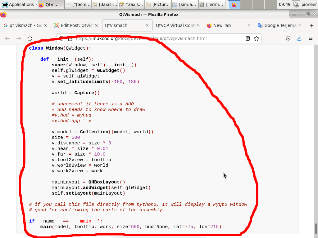

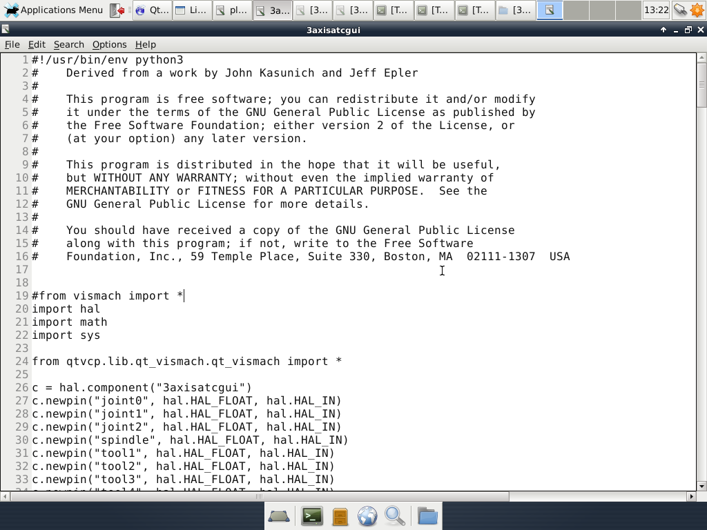

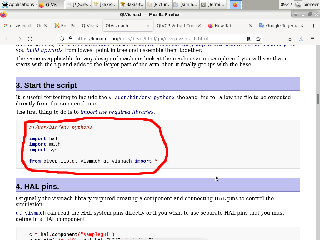

Hello can help me..
how to install Qt Vismach panel in AXIS gui, I use Linuxcnc (Debian Wheezy)
I tried to enter the script:
######################!/usr/bin/env python3
import hal
import math
import sys
from qtvcp.lib.qt_vismach.qt_vismach import *
etc
import hal
import math
import sys
etc

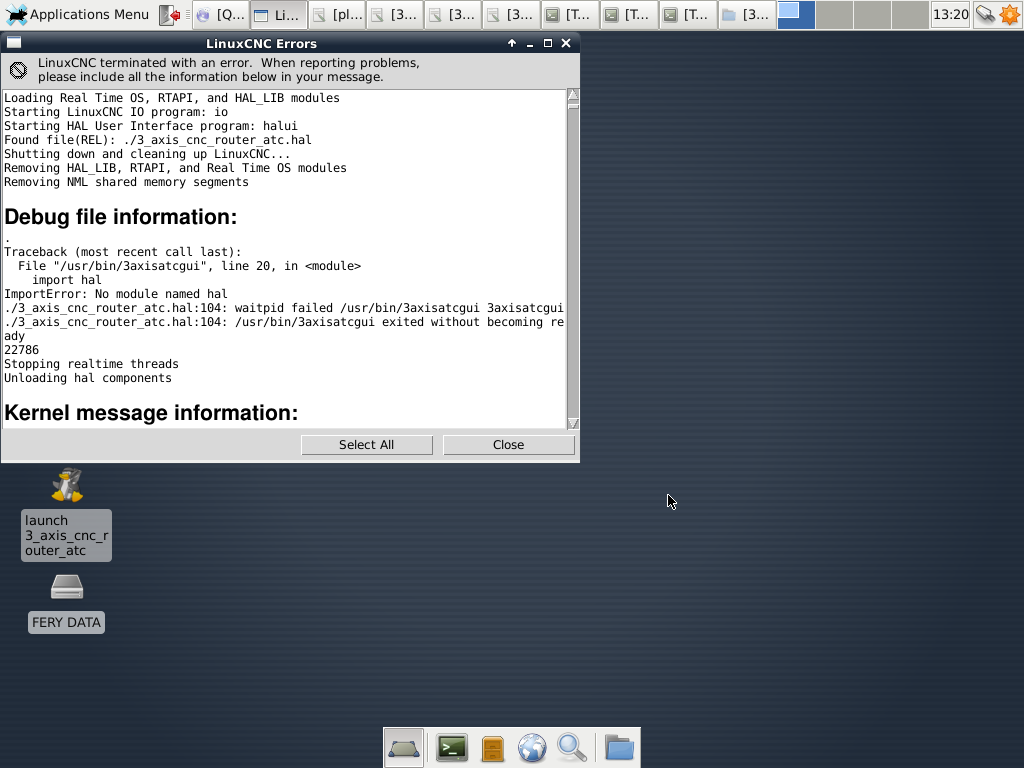

This seems like an error message related to python version.
What version of linuxcnc are you using?
I dont think I have tried qtvismach with python 2 but it's probably possible.

I using linuxcnc 2.7.15 in debian wheezy.
Maybe the qt vismach library needs to be added?

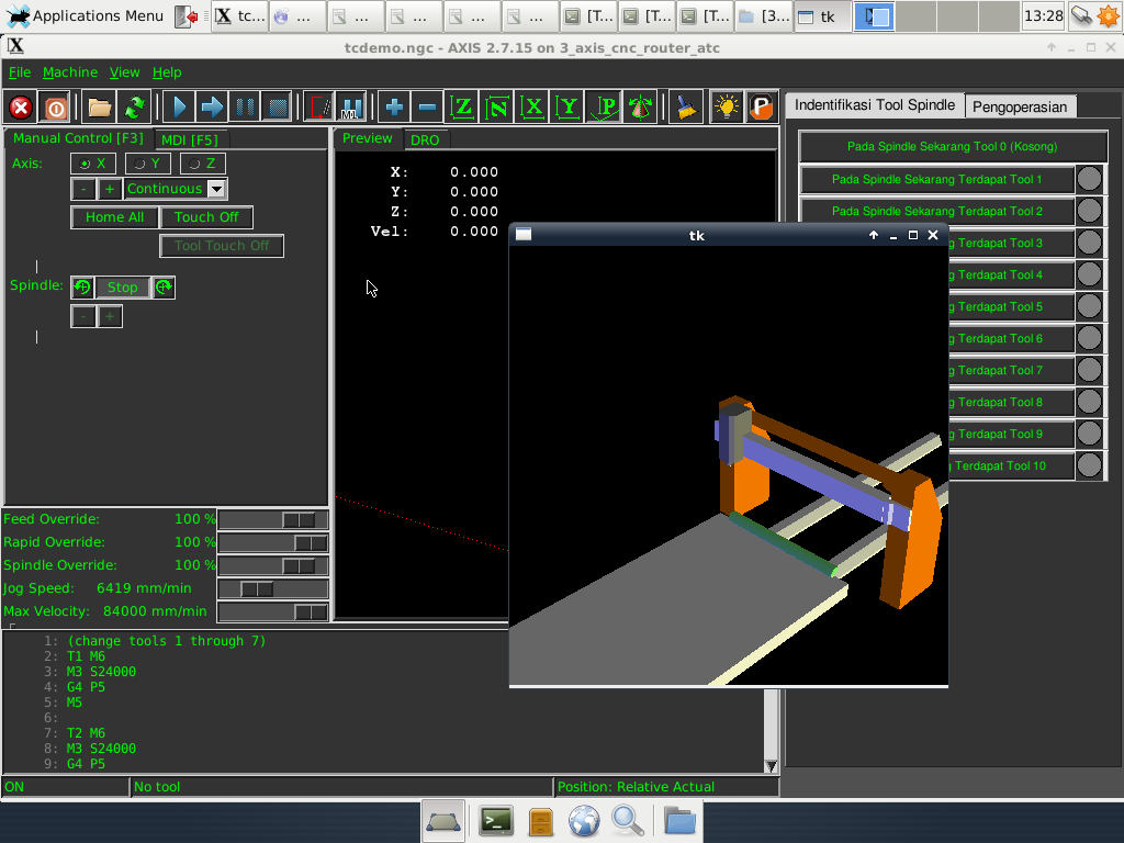

Ok.. i have installed debian 10. but i can't move vismach simulation to axis tab like your example..please guide me step by step, what should i do?

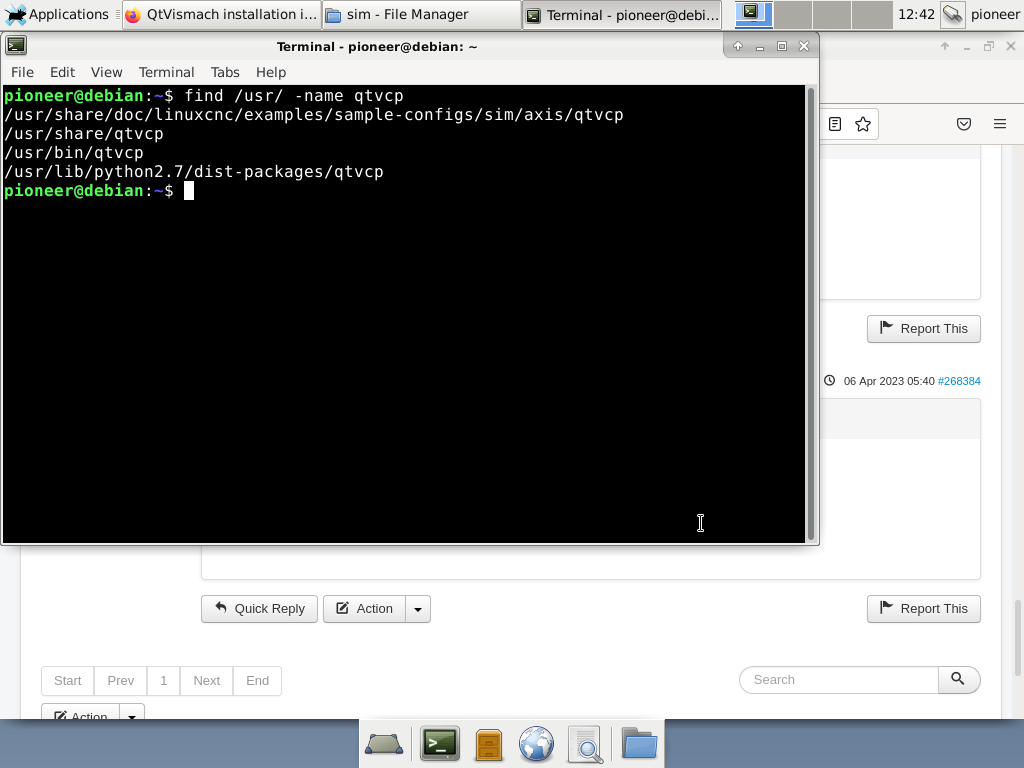

Is there a sim screen called:
axis/qtvcp/qtvismach_tab ?
Does it work?
Does it work?

No where do i find? axis/qtvcp/qtvismach_tab ?
- fery15sty
- Posts: 88
- Thank you received: 12
06 Apr 2023 05:44 #268385
by fery15sty
Replied by fery15sty on topic QtVismach installation in Linuxcnc (debian wheezy)

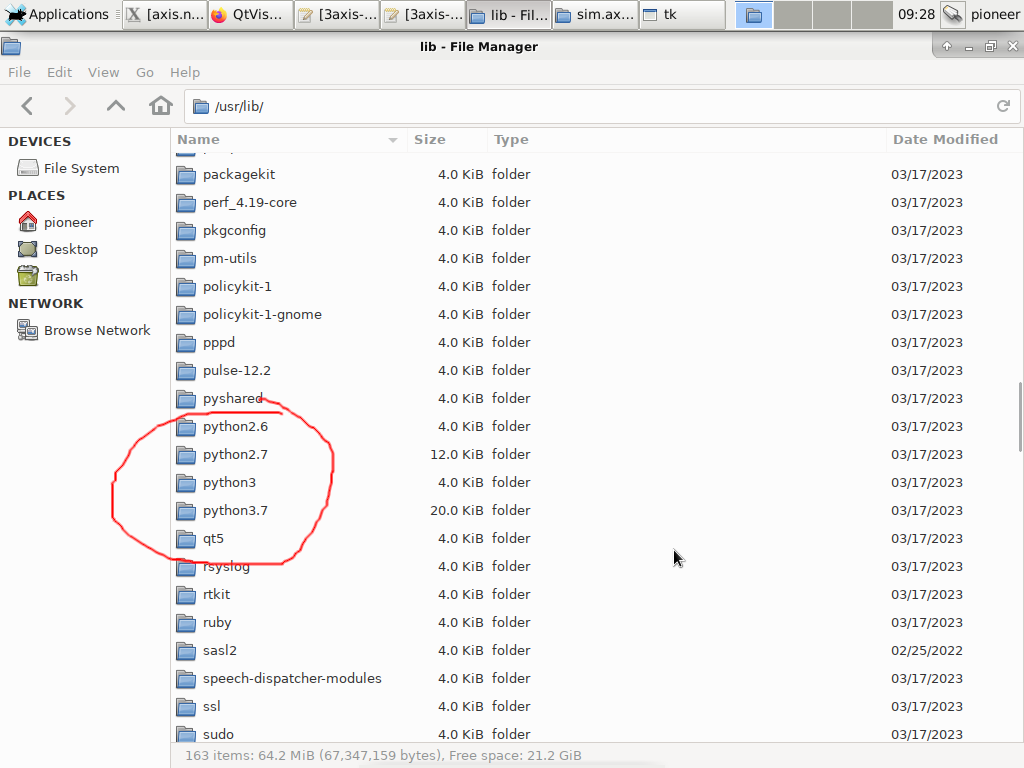

I found several directories that contain qtvcp
