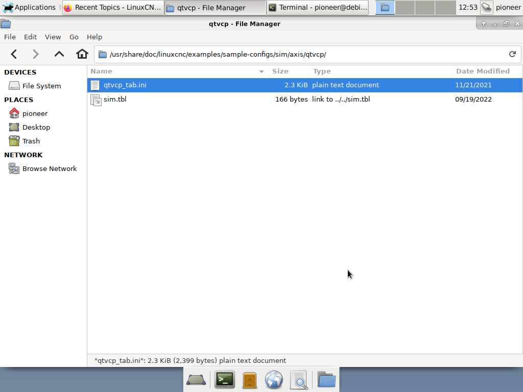

i found qtvcp_tab.ini
- Posts: 21901
- Thank you received: 7465
06 Apr 2023 10:19 #268404
Replied by tommylight on topic QtVismach installation in Linuxcnc (debian wheezy)
Right click on it, choose "open with" , near the bottom should be "use custom command" or similar, type linuxcnc there and click open.

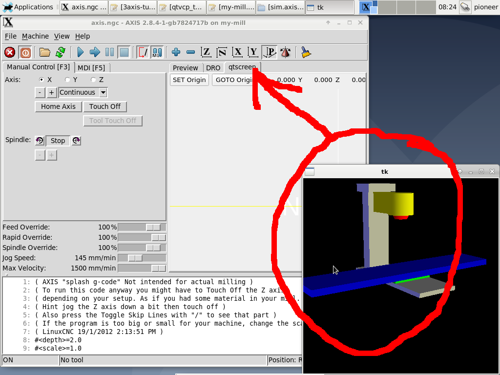

Looks like you are stilling using a python 2 based linuxcnc.

Looks like you almost got it, but I think that is regular vismach with the qtvcp camera tab
replace cam_align with what ever QtVismach is called
Also, need to set up vismach for qtvismach
linuxcnc.org/docs/devel/html/gui/qtvcp-vismach.html
EMBED_TAB_COMMAND= halcmd loadusr -Wn qtvcp_embed qtvcp -d -c qtvcp_embed -x {XID} cam_alignAlso, need to set up vismach for qtvismach
