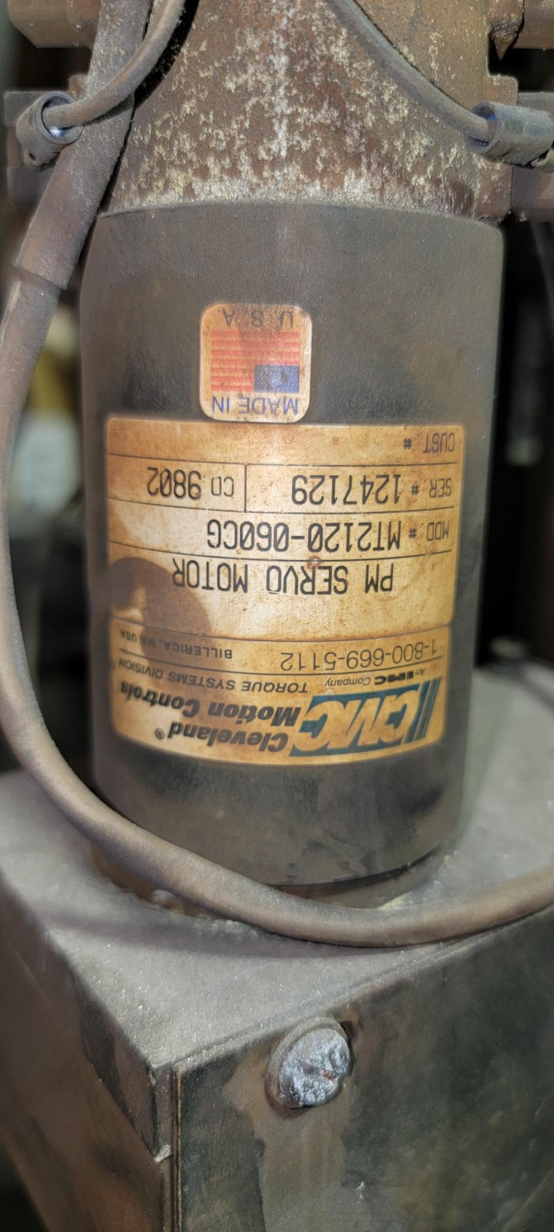

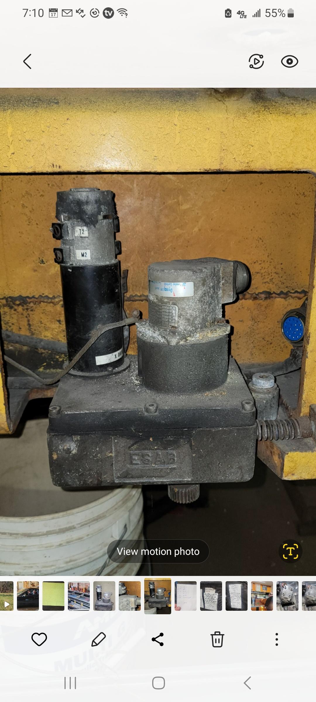

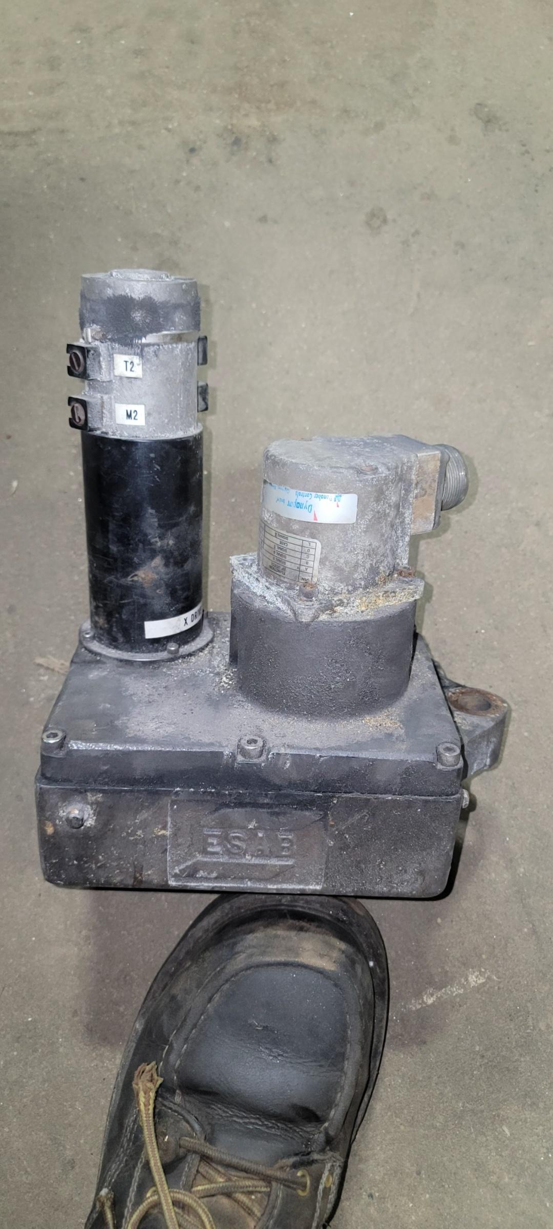

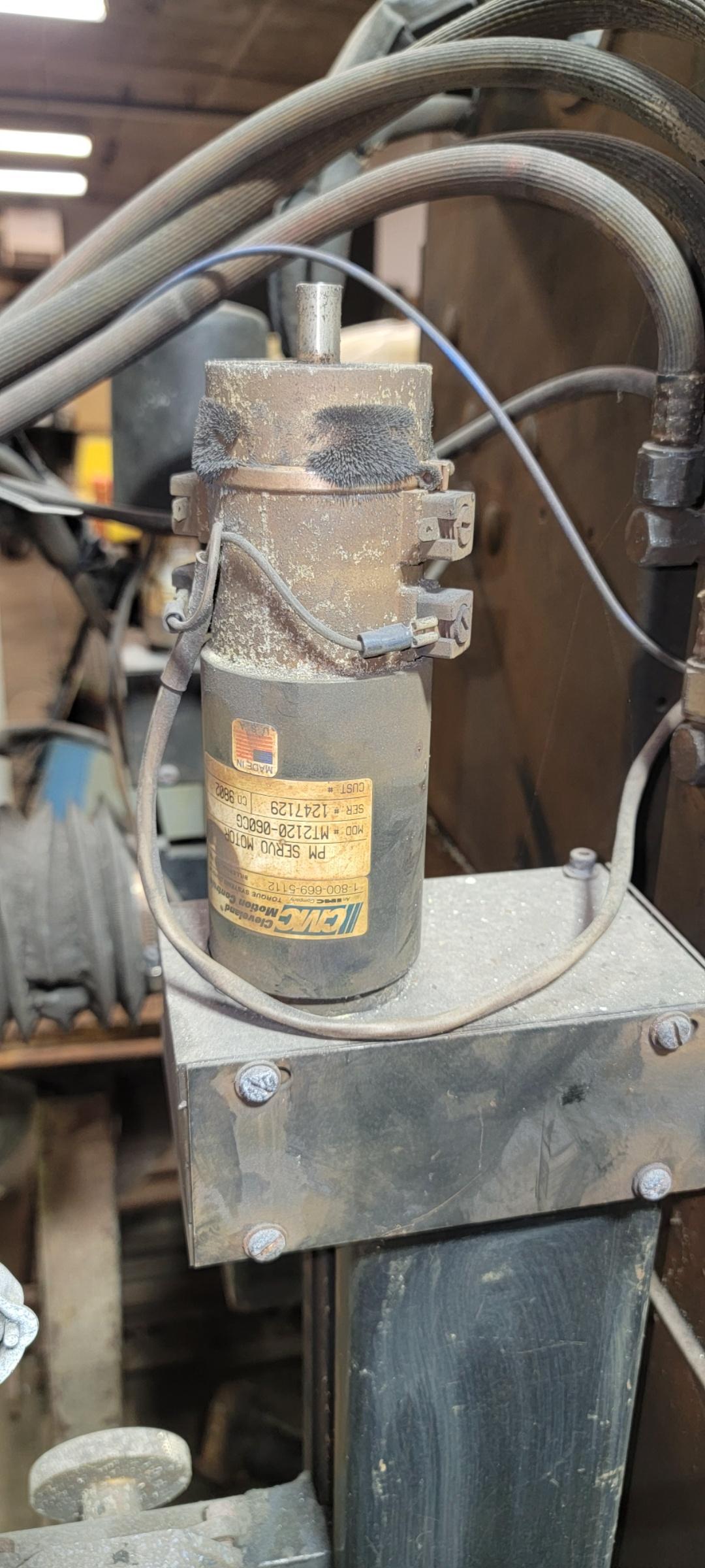

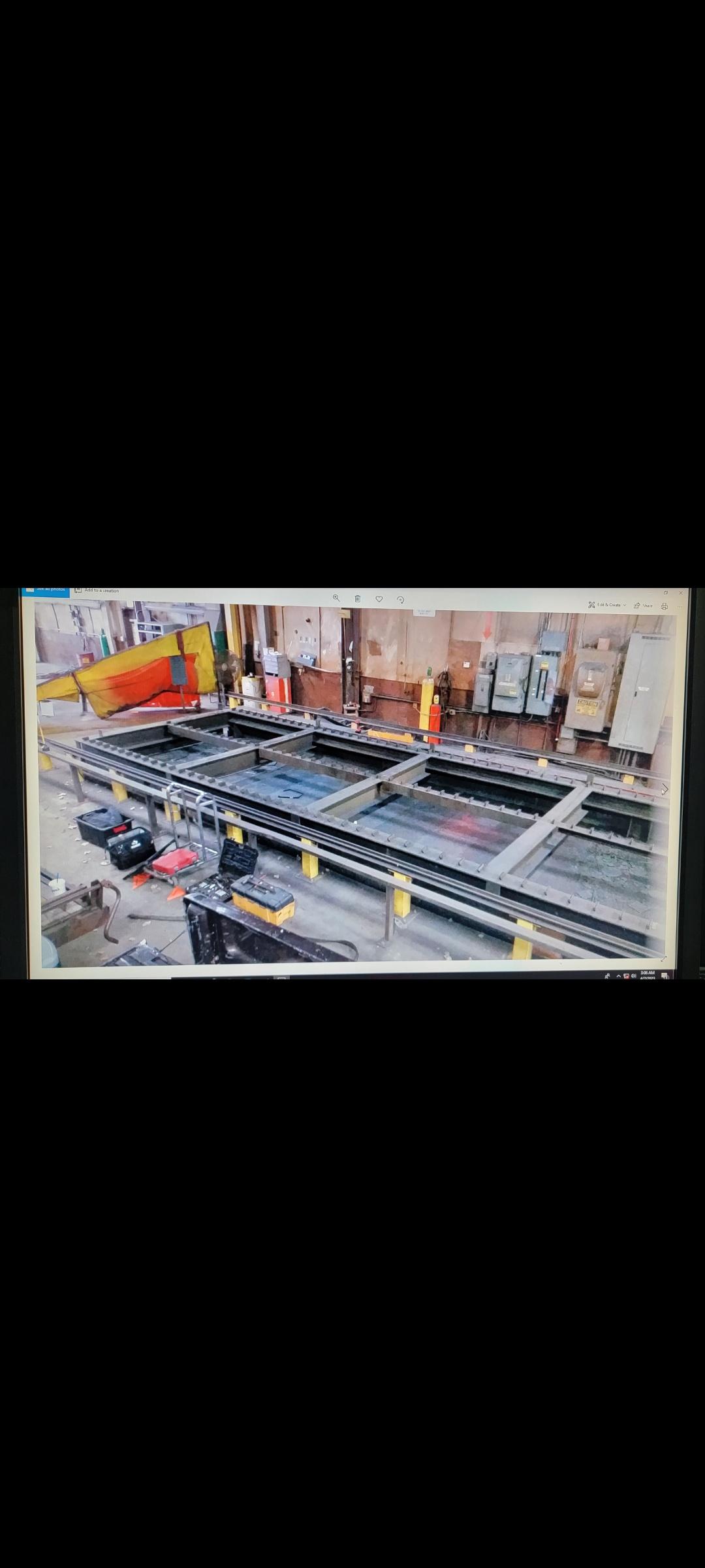

Here are a few pictures of the bed of the cnc plasma before I cut it in 4 pieces, to move it. The second and 3rd pic's are The Z axis motor. and the last 2 pics are the X and Y axis motors. Would anyone be able to tell me if these motors will be good to use or should I change the motors. If these are good motors? what drives would be recommended? I can't tell what typ of motors these are AC or DC "rock out"

Brushed DC motors.
Encoders are rusted badly, open the lids and check the sloted disc, if there is rust they should be replaced.

I opened them up and they look very clean on the inside, Surprisingly. Do you think id be happy with the performance of these motors? or would you recommended starting fresh with something better? either way im gonna need new drivers so I could go either way.

Should do just fine.
