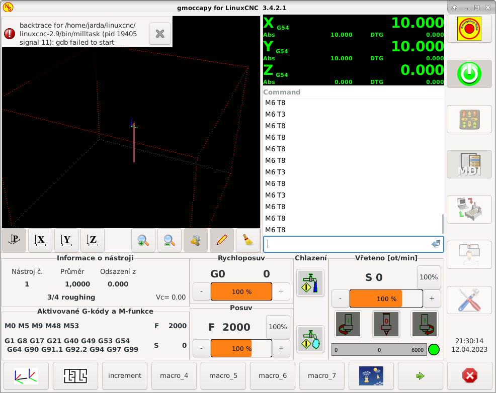

12 Apr 2023 15:36 #268902 by zz912
Replied by zz912 on topic Remap M6: Is this philosophy possible?
Hello,
I am trying to remake my Remap from O-word to python only.
At first I only had:
REMAP = M6 modalgroup=6 python=remap_m6
It doesn't work for me, so I split it up again
REMAP = M6 modalgroup=6 prolog=change_prolog python=remap_m6 epilog=change_epilog
But it still doesn't work.
Question #1 Do I have to use epilog and prolog if I only want python?
Here is my code:

This code behaves very strangely. When I enter the M6 T5 command in MDI, linuxCNC freezes for about 5 seconds, then the LCNC behaves as if the M6 T5 command is executed, then it is necessary to wait about 30 seconds, and suddenly, out of nowhere, the code starts running.
I also have the problem that the command does not work for me:
hal.set_p("atc.0.py-carousel-en","1")
Can I ask somebody for help?

12 Apr 2023 19:36 #268926 by zz912
I solved problems before, but I have new problem.

The problem is that if I don't use yield INTERP_EXECUTE_FINISH, my python code doesn't work properly.
If I use the yield INTERP_EXECUTE_FINISH, the python code works correctly for me, but it ends with a signal 11 error, see the image.
