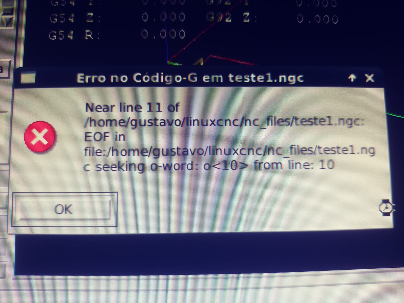

Hi everyone. I am new on LINUXCNC and I am having a hard time to run sub rotines. I am starting with a very simple positioning sub rotine as I am planing to remap the M6 to use an automatic tool changer.
I am probably doing something wrong. Could someone help me with that?
I am attaching a few pictures about the problem.
1- the program that calls the subrotine

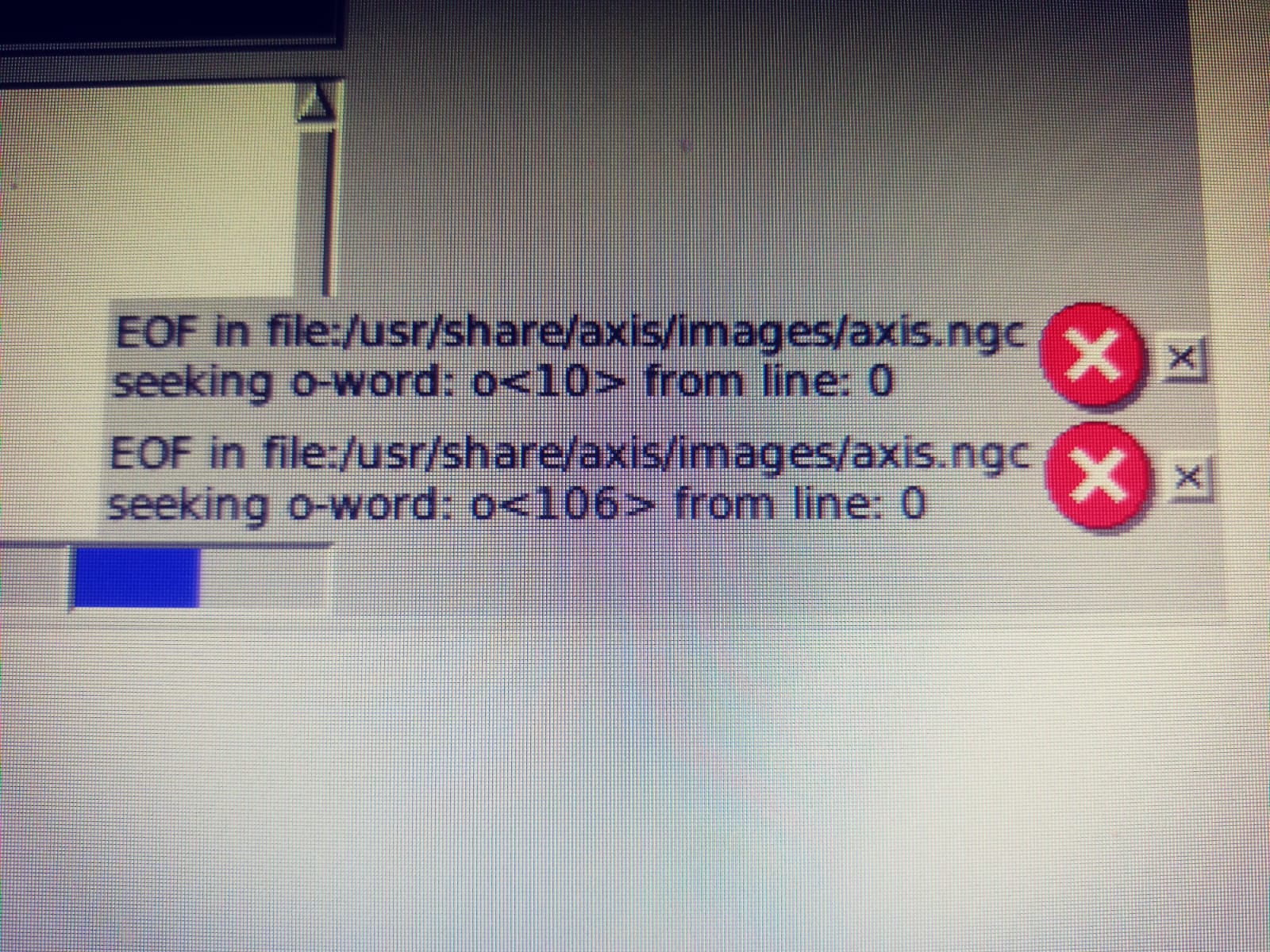

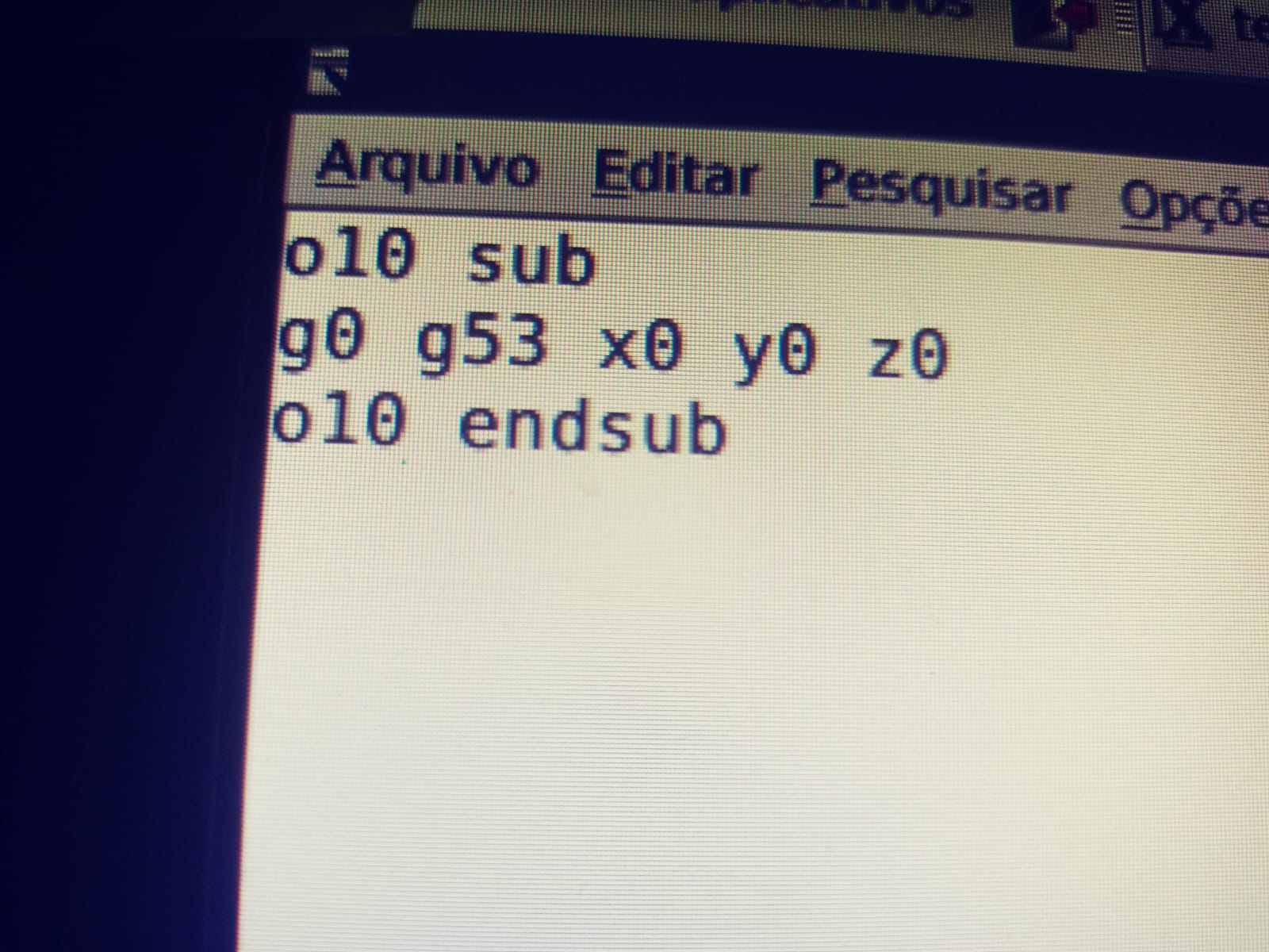

2- the subrotine
3 and 4- the alarms that shows up when runing the program that call the subrotine (one of the alarms of picture 4 shows an alarm calling O106 that was a second try with another rotine).

It should work, if the numbered subroutine file is called by 'o10 call' ,and stored as 10.ngc in the subroutine path.

My mistake I was saving the subroutine as O10.ngc instead of 10.ngc
