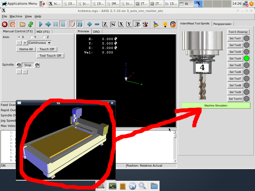

Open or close vismach with pyvcp button
- fery15sty
- Posts: 88
- Thank you received: 12
15 Apr 2023 07:38 #269064
by fery15sty
Open or close vismach with pyvcp button was created by fery15sty
- Posts: 19896
- Thank you received: 4648
15 Apr 2023 08:44 #269073
Replied by andypugh on topic Open or close vismach with pyvcp button
I think that you would need to keep a copy of the process ID then send it a terminate event. (SIGTERM ?)
Not sure of the details, just trying to supply some google search keys

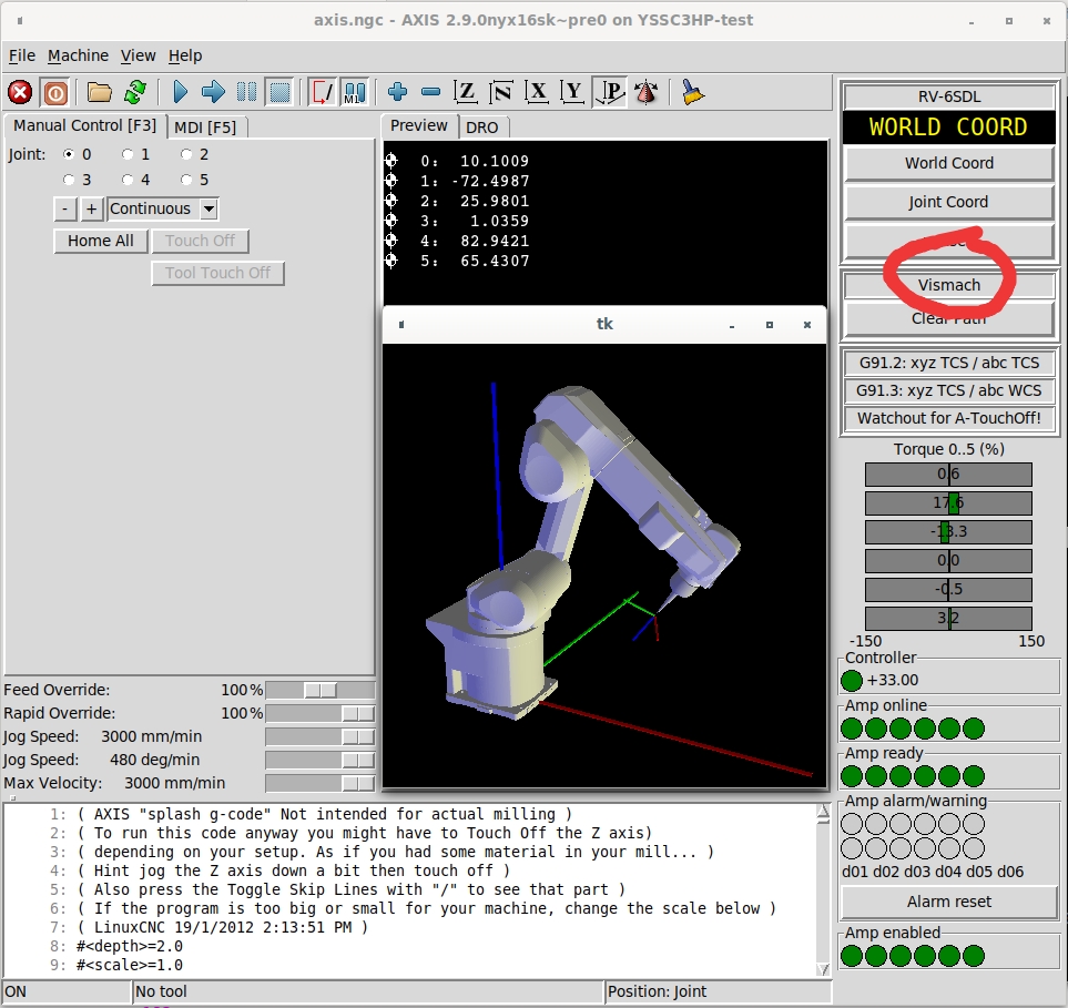

I think maybe the way is not difficult. i've seen posts that use buttons to activate vismach. like this post:
forum.linuxcnc.org/38-general-linuxcnc-q...r-usability?start=10
but i don't know how to do it
- Posts: 4811
- Thank you received: 2164
15 Apr 2023 11:19 - 15 Apr 2023 11:32 #269095
Replied by Aciera on topic Open or close vismach with pyvcp button
Actually that is not a button but just a label. The button is below that and is to clear the path plot in the vismach window. Vismach is loaded automatically at startup.
[edit]
I don't know if it's possible to start/close vismach from a button but you would somehow have to link/unlink the hal connections of the vismach model.
[edit2]
In qt-axis you can embed the vismach model as a tab in the axis window so that may be a more straight forward path.
[edit3]
I just noticed your other thread and that you are already trying to embed vismach as a tab. cmorley should be able to help you there.

how to clear path in vismach?
- Posts: 4811
15 Apr 2023 14:41 #269110
Yes, to clear the pinkish/orangy tool backplot line that shows where the tool tip has moved.
The following user(s) said Thank You: fery15sty
- fery15sty
- Posts: 88
15 Apr 2023 17:48 #269135
by fery15sty
Replied by fery15sty on topic Open or close vismach with pyvcp button
yes, how is that..?
- Posts: 4811
15 Apr 2023 18:24 #269140
Maybe try it out.
Start one of the sim configs in the axis/vismach section and move the machine about and you should see the backplot in the vismach simulation then click the 'clear' button. I'm not sure if all the configs have the 'clear' button available. The ones in the '5axis' section should.

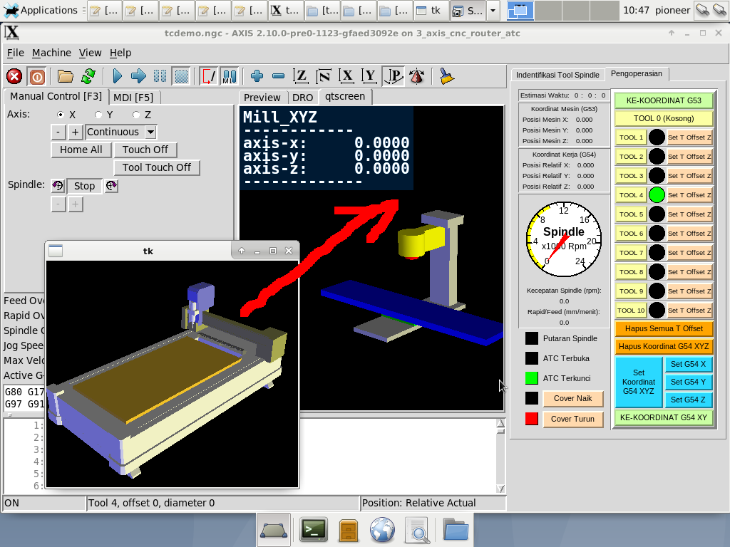

pyvcp can only control HAL pins so can't load/open programs.
Gladevcp or qtvcp could though.using python extentions.
in 2.9 you can embed qtvismach into AXIS's tabs.
