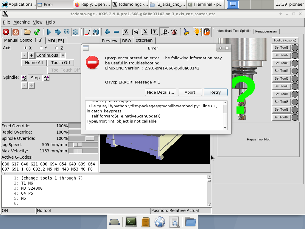

17 Apr 2023 06:47 - 17 Apr 2023 06:57 #269280
by fery15sty
Replied by fery15sty on topic Open or close vismach with pyvcp button
when I jog faster, an error like this occurs
Traceback (most recent call last):File "/usr/lib/python3/dist-packages/qtvcp/qt_makegui.py", line 110, in keyPressEventself.keyPressTrap(e)File "/usr/lib/python3/dist-packages/qtvcp/lib/xembed.py", line 81, in catch_keypressself.forward(e, e.nativeScanCode())TypeError: 'int' object is not callable

17 Apr 2023 17:37 #269316
Replied by cmorley on topic Open or close vismach with pyvcp button
Ok I got it fixed and pushed it to the repos.
Here is the commit if you need to do it manually:
github.com/LinuxCNC/linuxcnc/commit/c8c2...f6fb0d6f21994dc78cfd
Ends up after fixing the initial error, a worse problem showed: key press would work but key release didn't - very dangerous.
I got that fixed too.
Please let me know how it works for you.
Chris

18 Apr 2023 04:03 #269349
by fery15sty
I've tried it, and it works fine.
Thank you for your time..
