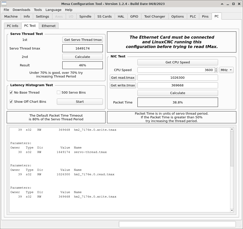

And NIC test? Click Calculate.

Wild. Now Servo thread is 82% and NIC test is 91.5%

Replied by rodw on topic Upgrading both Linux and LinuxCNC
I think you need to hit the calculate button on the right after reading the values.
You need to run linuxcnc for an extended period
But from what I'm seeing it looks OK
Calculation is: 1220206 timer ticks /3600 Mhz = 338 usec so 33.8% of the servo period
It looks like you have 2 x intel network cards which is a good thing. Did you do the coalescense thing? It is required for Intel cards
linuxcnc.org/docs/2.9/html/man/man9/hm2_...FACE%20CONFIGURATION
If you have, I would try swapping the mesa card to the other NIC.

You can't look at latency (except network larency) with linuxcnc running which may explain your high value.

Servo thread test is not latency test.
Replied by zz912 on topic Upgrading both Linux and LinuxCNC

I'm trying to pass those tests:
latency test
latency histogram
Servo thread test
NIC test
I would like ask you for printscreen with this high value, or with some high value.Wild. Now Servo thread is 82% and NIC test is 91.5%
latency test
latency histogram
Servo thread test
NIC test

A couple recent things I have found that improve network
latency on difficult PC cases are:
1. The 6.3 kernel
2. Using the busywait LinuxCNC branch
1. The 6.3 kernel
