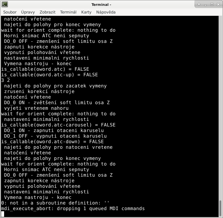

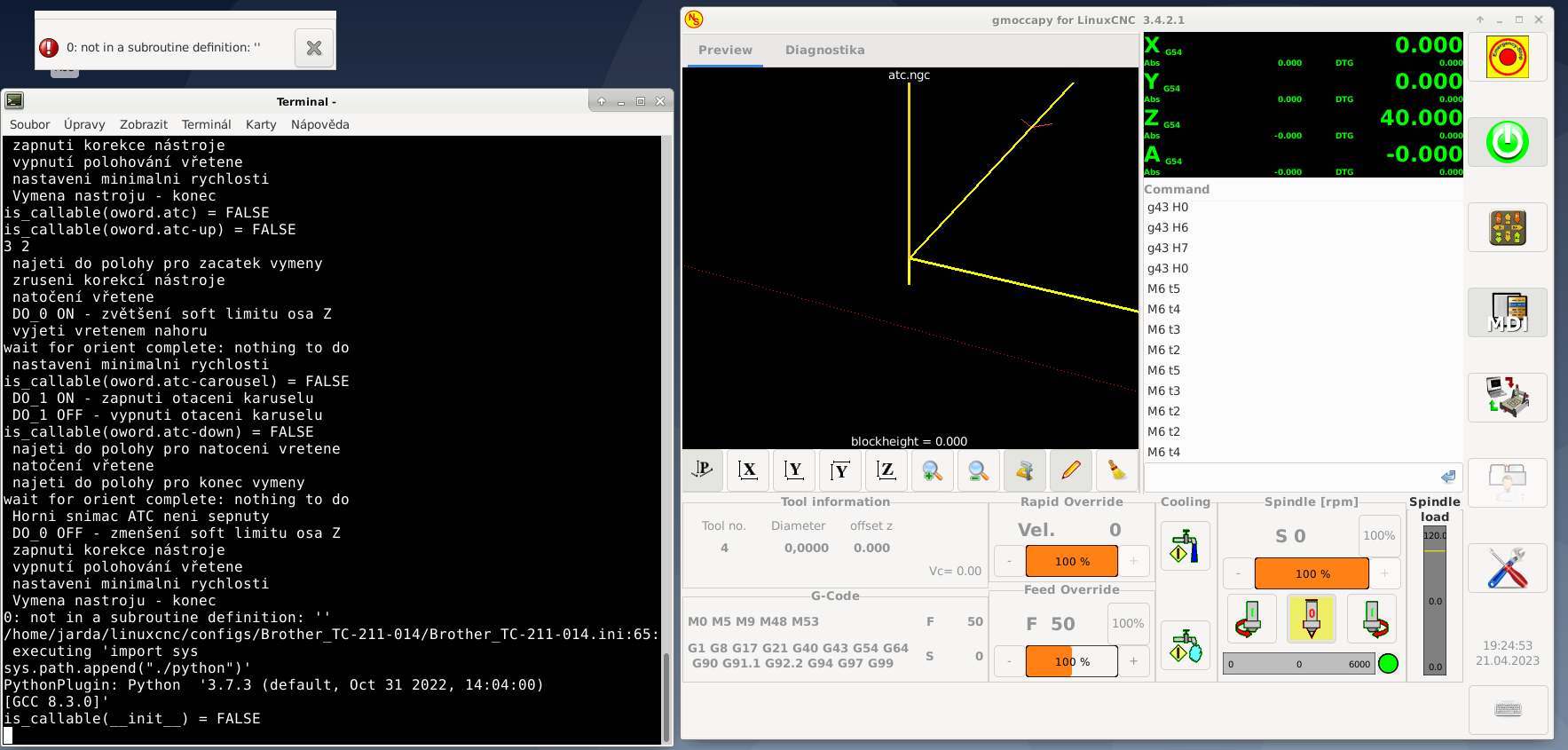

Hello,
I have LCNC 2.9 Branche. I made remap M6.
If I make several M6 TX command, sometimes it returns this bug:
My biggest problem is, that this bug is random.
Here is my files for Remap:
REMAP = M6 modalgroup=6 prolog=change_prolog ngc=atc epilog=change_epilog
Message is here:
github.com/LinuxCNC/linuxcnc/blob/160c55...nterp_o_word.cc#L825
Is it my bug? Is it LCNC bug?
I don't know how to continue looking for a bug. I would like to ask for help.

In interpreter source code is function:
This function contain messages. Is it possible to display these messages, for example, in the terminal?
logOword("This function contain messages. Is it possible to display these messages, for example, in the terminal?
