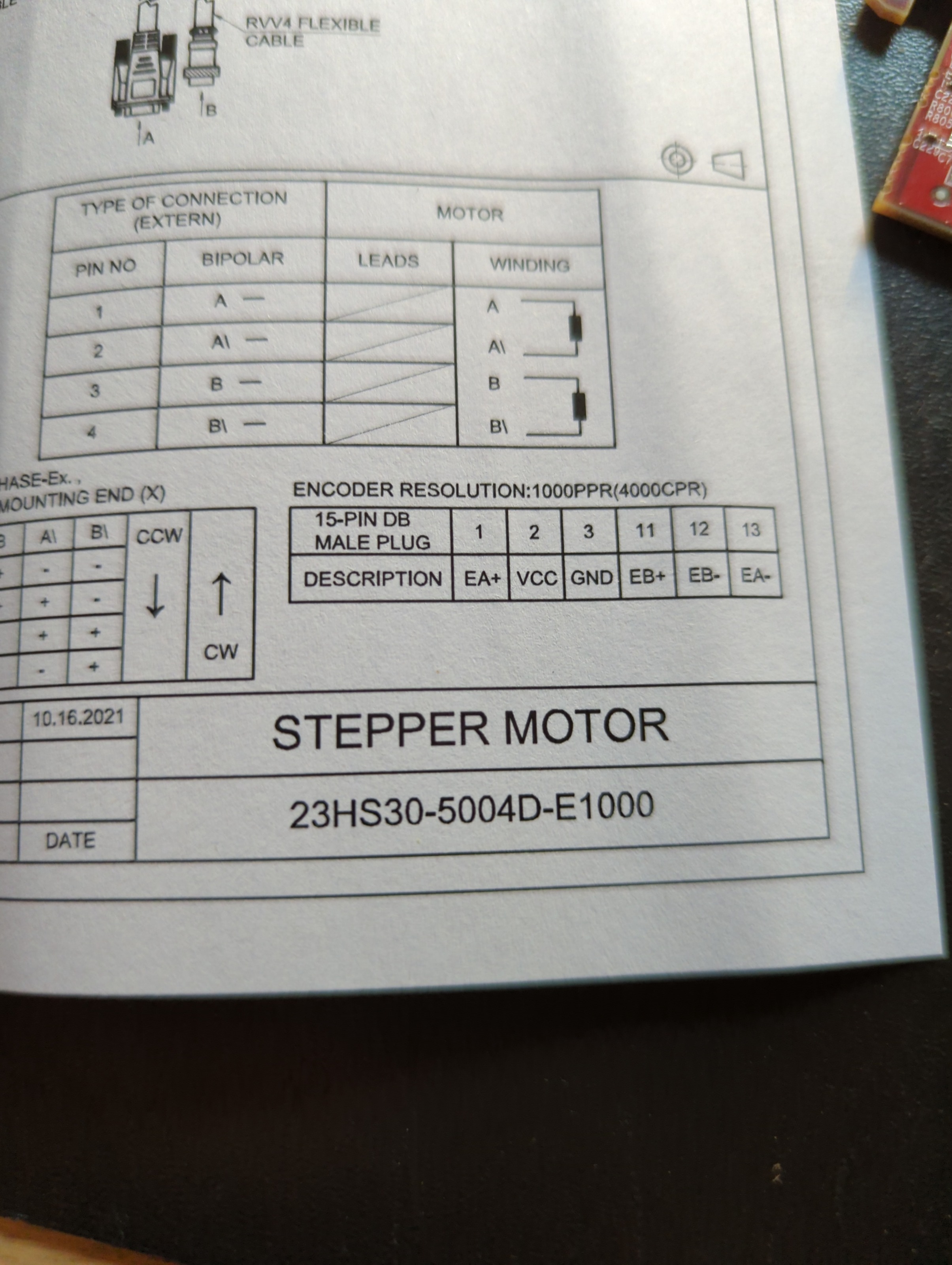

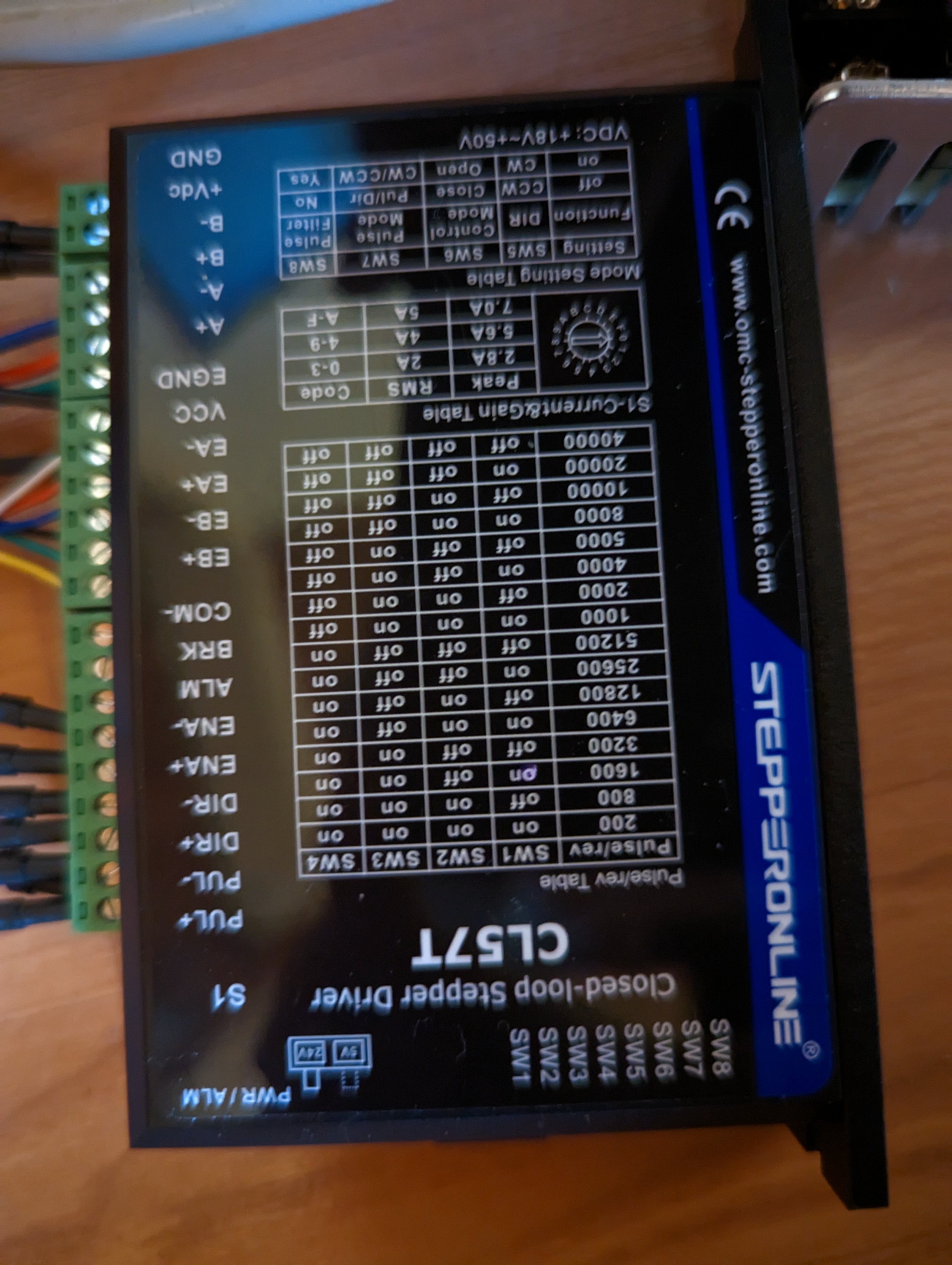

Hello,I have since my last post have been able to get the jitter down by using onboard graphics. Now i am test wiring one of my motors and drivers. (See pic's in attachment) After a whole lot of trail and error i got the motor working in stepconf, when using the 'test stepper function' i van move the motor with the jog button, but only in one direction. The stepper deels to be Running very smoothly.

First suspect would be that the DIR signal is not connected properly, either in the linuxcnc setup or the on the breakout board
