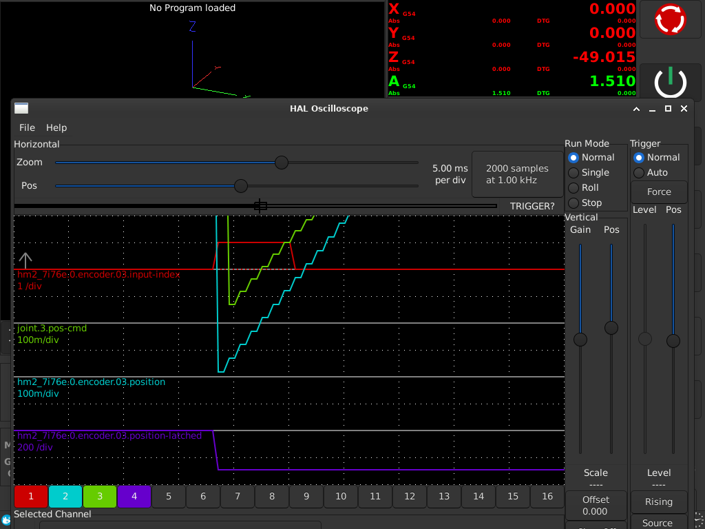

22 May 2023 08:57 - 22 May 2023 09:07 #271908
Replied by Aciera on topic Rotary axis homin on index not working
So, i tried with changing the pid values in the ini but the offset is unaffected. The offset value increases proportionally with the homing latch velocity. What I did notice is that the encoder position does not seem to reset to zero:

22 May 2023 09:20 - 22 May 2023 09:40 #271914
Just to be clear, this offset does stay. If I do a G53 G0 A0 it does not go to zero. If I set the work offset to the current position the value does also not go to zero. All positional values for the rotary axis are offset by this amount. In the above example if I do G0 A100 it (the DRO) goes to 101.510.
I can see slight changes in the DRO value when I apply torque to the motor shaft, so it is indeed the encoder value.
[edit]
Another observation: Even with conservative following error setting like
FERROR = 10
MIN_FERROR = 1
I get a following error during homing as soon as the index signal is detected. Not sure if that may have something to do with this.

22 May 2023 11:54 #271925
Replied by Aciera on topic [SOLVED] Rotary axis homin on index not working
Turns out that the PID settings in the ini were the key to the solution.
Following error must be minimized properly using the pid settings in linuxcnc for homing to work correctly.
Seems obvious now. Thanks for all the support!
- Posts: 4811
- Thank you received: 2164
22 May 2023 18:03 - 22 May 2023 18:57 #271954
A little update on this matter.
Just as a recap: The optimal P value in the ini would be 1 since we already have a pid in the servo controller that should bring the motor position to the commanded position set by the stepgen.
However, it seems that with a P value of 1 in the joint PID the overshoot of the stepgen count in the index homing process never gets corrected and just stays in the DRO. That is why the offset gets propotionally larger with higher homing latch speed. Hence a sufficiently larges P value is required to eliminate the offset. ie the larger the P value the faster the stepgen and the motor are brought back to the index position (ie encoder zero).
[edit]
Problem is that, after homing is complete this P value leads to overshoots in the position commands.
Just tried setting the p value to 1 after homing and that did not bring the solution to my following error. Not sure as to what to do here but I've got a f-error of 15 when the motor is jogging or en route to a commanded position. Controller - Servo are auto-tuned for a rigid machine. Manual tuning seems a daunting task ...
