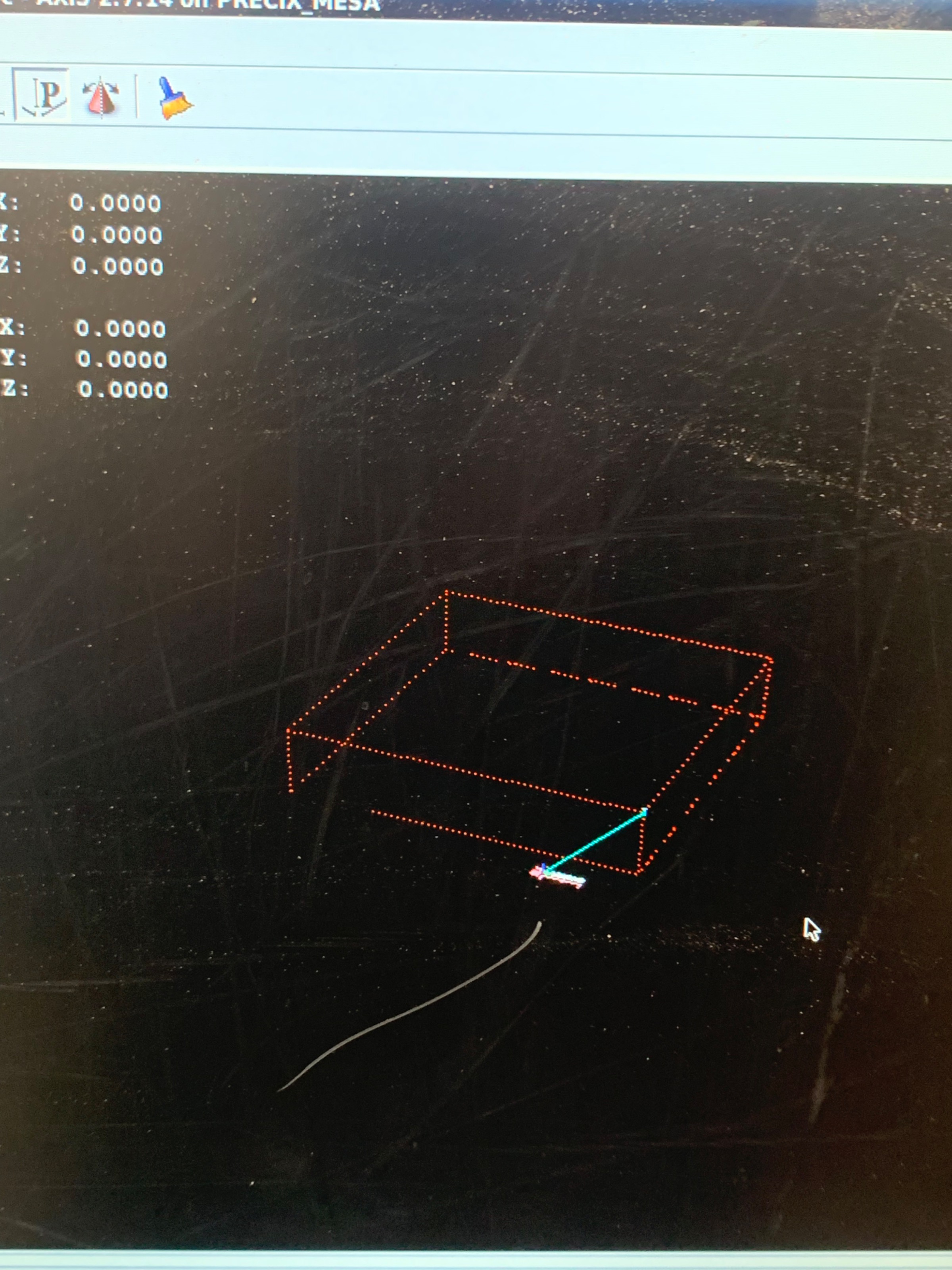

Why does Linux show that the origin starts all the way to the right of the bed? I don’t have experience with fixing this but I want to try to understand what is causing it. Everything has been normal up until today when I opened the program and it shows this incorrect info now.

Look at G54 offsets. Set to zero and see if that helps

Thank you very much for the suggestion. This is a shared CNC in a communal shop, and I’ve had no luck in contacting the person who set up the machine. Unfortunately I don’t know how to set G54 offsets to zero (or anything of that nature). Is it possible to be walked through how to do this in Linux, or it’s not so simple and requires coding?

To set g54 offsets to 0 do the following commands in the MDI window, in the same order:
CAUTION: The milling will move to machine coordinate 0,0,0 after the first line is entered.
G53 G0 X0 Y0 Z0
G92.1
G54
G10 L2 P1 X0 Y0 Z0
G49
G53 G0 X0 Y0 Z0
G92.1
G54
G10 L2 P1 X0 Y0 Z0
G49

Usually before you start using your machine it must be homed. In that way your machine will know the position of your spindle. After homing you need to use either g54 to g59 as your part coordinate system. So you need to position your spindle to your part so that it matches to the origin of your design. Disregard the visualizer, just focus on the actual spindle and part, then approximate the position of the origin base on your design. This is your touch off position. If you are not familiar with that linuxcnc macro buttons and decided to use G54, in the MDI window G10 L20 P1 X0 Y0 Z0. After this type G54, since it is a modal type it will be use throughout the job unless you replace it with other working coordinate system.
