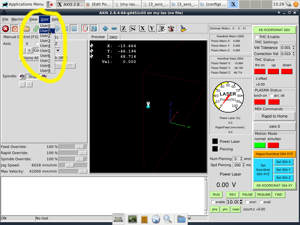

can anyone help me..
can i use user-command (0-9 number in keyboard) to be a momentary signal.
I do not know what to do.
in my ini file, like this:
[USER_COMMANDS]
USER0 =
USER1 = #setp or2.4.in1 1
USER2 =
USER3 =
USER4 =
USER5 =
USER6 =
USER7 =
USER8 =
USER9 =
NUMBER KEYS = YES
[USER_COMMANDS]
USER0 =
USER2 =
USER3 =
USER4 =
USER5 =
USER6 =
USER7 =
USER8 =
USER9 =
NUMBER KEYS = YES

I use the method as in this link.
forum.linuxcnc.org/21-axis/27577-axis-user-defined-keys
I want to make a custom keyboard to connect to the hal pin.
I don't know any other way to custom keyboard button

I have done the for custom axis.py dan axis.tcl, and it can run on 2.8,but the signal on the button works like a toggle with a locked signal, I want the button to work like a push button, with a momentary signal

SOLVED
I use the manual method as used in jog_plus and jog_minus in axis.py.
and all working..
r = axisui.key-run-adaptive
p = axisui.key-pause-adaptive
s = axisui.key-resume-apadtive
m = axisui.key-forward-adaptive
n = axisui.key-reverse-adaptive
and all working..
def run_adaptive(event=None):
comp['key-run-adaptive'] = 1
def pause_adaptive(event=None):
comp['key-pause-adaptive'] = 1
def resume_adaptive(event=None):
comp['key-resume-adaptive'] = 1
def reverse_adaptive(event=None):
comp['key-reverse-adaptive'] = 1
def forward_adaptive(event=None):
comp['key-forward-adaptive'] = 1
def stop_adaptive(event=None):
comp['key-run-adaptive'] = 0
comp['key-pause-adaptive'] = 0
comp['key-resume-adaptive'] = 0
comp['key-reverse-adaptive'] = 0
comp['key-forward-adaptive'] = 0
root_window.bind("<KeyPress-r>", nomodifier(commands.run_adaptive))
root_window.bind("<KeyRelease-r>", commands.stop_adaptive)
root_window.bind("<KeyPress-p>", nomodifier(commands.pause_adaptive))
root_window.bind("<KeyRelease-p>", commands.stop_adaptive)
root_window.bind("<KeyPress-n>", nomodifier(commands.reverse_adaptive))
root_window.bind("<KeyRelease-n>", commands.stop_adaptive)
root_window.bind("<KeyPress-m>", nomodifier(commands.forward_adaptive))
root_window.bind("<KeyRelease-m>", commands.stop_adaptive)
root_window.bind("<KeyPress-s>", nomodifier(commands.resume_adaptive))
root_window.bind("<KeyRelease-s>", commands.stop_adaptive)
comp.newpin("key-run-adaptive", hal.HAL_BIT, hal.HAL_OUT)
comp.newpin("key-pause-adaptive", hal.HAL_BIT, hal.HAL_OUT)
comp.newpin("key-resume-adaptive", hal.HAL_BIT, hal.HAL_OUT)
comp.newpin("key-reverse-adaptive", hal.HAL_BIT, hal.HAL_OUT)
comp.newpin("key-forward-adaptive", hal.HAL_BIT, hal.HAL_OUT)
