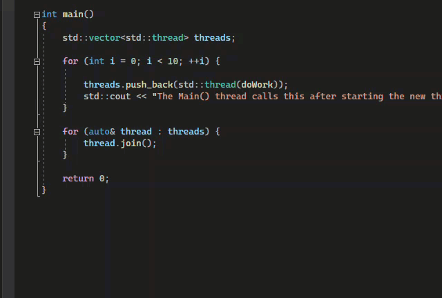

I'm looking for a way to find out how some parts of the code work. At the moment, I mainly read the code and verify its functionality by writing appropriate information to the console using the print function.
If I could open LCNC in Microsoft's Visul Studio, I could see step by step how the code is read.
I'm not insisting on using Microsoft's Visul Studio, but anything better than randomly browsing through files.
I wonder if there is a more efficient way of working.

import linuxcncI'm looking for a way to find out how some parts of the code work. At the moment, I mainly read the code and verify its functionality by writing appropriate information to the console using the print function.
