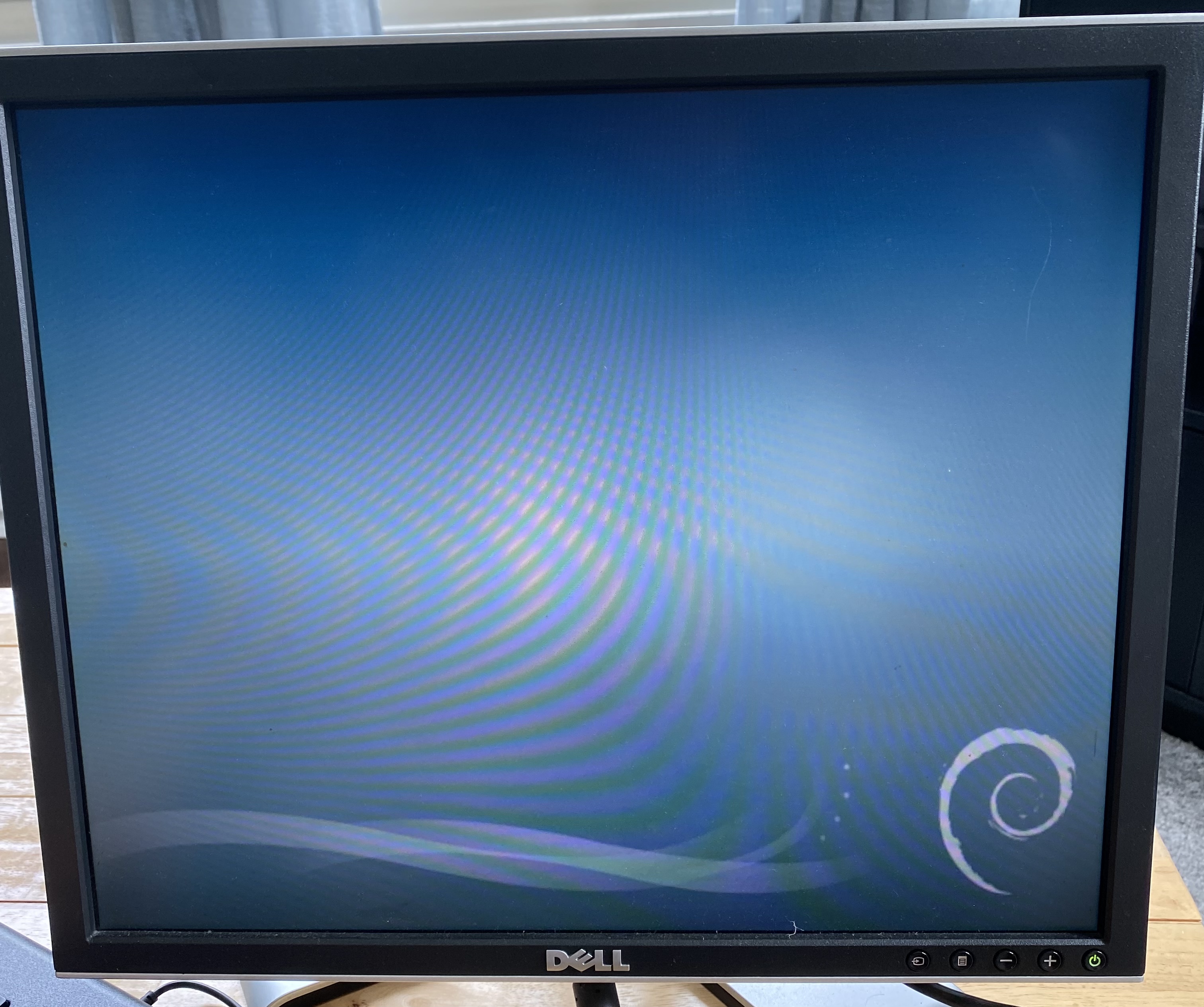

I gave this computer to a client a while ago and it has been working well for them up until this point. Every time we boot it up it brings me to the selection menu. After making the selection it freezes on one of two screens

15 Jun 2023 19:22 #273640
Replied by tommylight on topic Debian10 Username and Password
That should be an issue with the DE/File explorer, no idea what XFCE uses for those, and no idea how to fix it.
For Mate, there is a hidden DE settings file that should be deleted and after reboot it works.
Try searching Debian XFCE forums with search terms:
desktop shows with no icons and no task manager

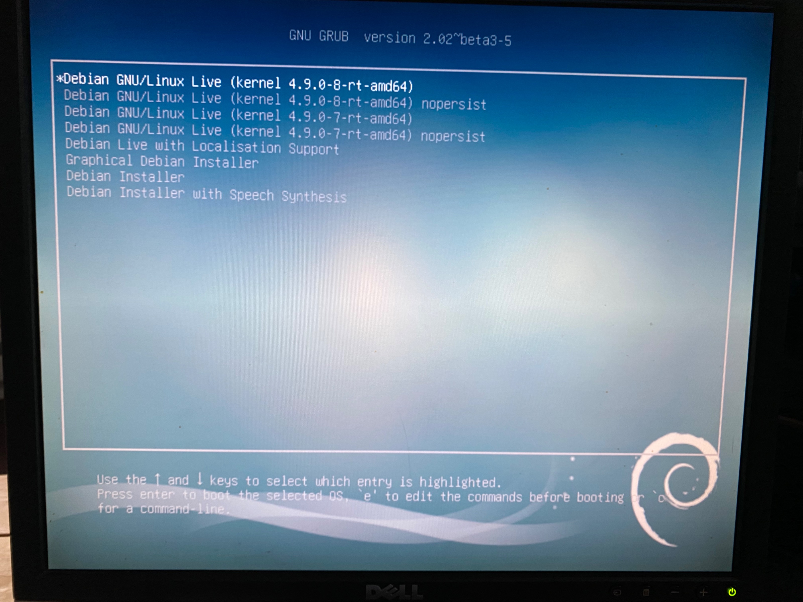

20 Jun 2023 11:03 - 20 Jun 2023 11:19 #273915
by Aldenflorio
Replied by Aldenflorio on topic Debian10 Username and Password
I couldn’t seem to find anything there that approached my issue. I switched computer towers entirely to see if that was the issue and it’s not. It’s not letting me though at all again though. This is a calibrated machine so I don’t want to ruin anything.
I don’t have many options within the boot menu.
they won’t let me into register a profile for the Ubuntu forms because I don’t know what this outputs
date -u +%jXfce|sha256sum|sed 's/\W//g'
this is my start up screen
Last edit: 20 Jun 2023 11:19 by Aldenflorio. Reason: Picture
- Posts: 12049
- Thank you received: 4113
20 Jun 2023 11:27 #273918
Replied by rodw on topic Debian10 Username and Password
Try hitting control-Alt-T
It should open a terminal window
Then try
rm -R ~/.cache/sessions/*
Logout and log in again without rebooting.
Hopefully it's fixed
Ref: askubuntu.com/questions/451847/desktop-i...click-on-the-desktop
I vaguely remember having this happen once years ago.
Then try

20 Jun 2023 11:29 #273919
by Aldenflorio
I got in and I’m leaving it on so it doesn’t freeze again. Though when it freezes at that screen I can’t do anything at all. I can’t even restart it.
since I’m in I can open the terminal and try that
