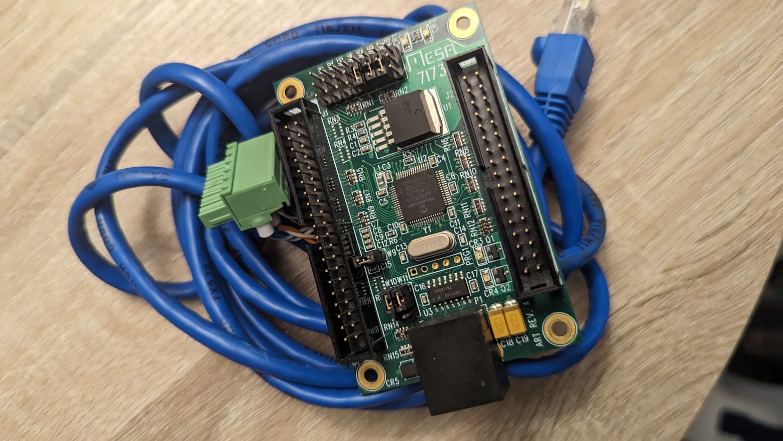

When you get a MPG wheel this is 100 PPR, I'm wanting to understand exactly what "100 PPR" means.
A single cycle of a quadrature encoder is a total of 4 edge changes from 2 outputs A & B.
So in the forward direction you get A going high, then B going high, then A going low, then B going low.
And in the reverse direction you get B going high, then A going high, then B going low, then A going low.
So does a 100 PPR MPG handwheel give 100 edge changes, which is actually only 25 quadrature waveform cycles.
Or is one "pulse" actually a complete quadrature waveform cycle, and thus a 100 PPR wheel will give 400 edge changes.

Last paragraph is OK.

Since my opening post I've been searching for data sheets on 100 PPR MPGs and one of them did show the wheel detents/stops with the 4 edge changes in between, so it's starting to make sense.
The next thing I have to understand is this "1x mode" the Peter from Mesa mentions a lot for use with MPGs, but my brain is starting to hurt and it's time for sleepies. I'll probably make a new post on that in a few days.

On a Mesa card with MPG inputs, they are not quadrature. This is the style you need. Check the images for connections
A, B, +5v, 0v
www.amazon.com/100PPR-Driver-Output-Wheel-Encoder/dp/B01EA9I5LW
I documented how I used a MPG like this in my original build thread

PPR = Pulses per revolution.
100 PPR encoder will have 100 pulses per revolution on channel A and on channel B, and those are shifted 90 degrees from each other.

I'm going to go over to the Mesa boards section to ask Pete a question on the 1x mode.
Rod,
I'm working on doing things a bit differently. I've gave up on that damn wireless XHC usb pendant.
Instead of a MPG jog wheel, I've programmed a microcontroller to emulate an MPG quadrature signal. So the Mesa board won't know any difference because all it sees is the incoming A & B quadrature signals and their phase shift representing forwards or reverse.
This way, instead of a multiplexer in hal for scaling, I can simply control the frequency of the quadrature signal with a selector switch on the pendant. Likewise a fwd/rev momentary rocker switch will control the phase shift of the quadrature waveform for direction.
Doing things this way I can have a serial connection between my pendant and the microcontroller which "feeds" the Mesa board, and I can have a trillion buttons on my pendant so no limit to the amount of things the pendant can do, so long as I have enough I/O on the Mesa card, which I don't think will be a problem at all once I interface to the P1 expansion port.
