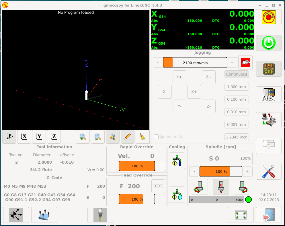

I apologize for duplicating the information I provided in the Gmoccapy section.
forum.linuxcnc.org/gmoccapy/49335-self-c...lete?start=10#274170
Unfortunately, no one helped me in this section, so I'm trying to put this information here, because more people come here. The Python Interface section is not here on the forum.
To avoid having to create my own button, I use the coolant button in Gmoccapy. I added this code to it:
Video:
The video shows that the LCNC is behaving as it should.
First, the X-axis moves by 10 mm.
The command.wait_complete() waits for the X-axis to finish.
Finally, the Y axis moves by 10 mm.
I added the following to the Gmoccapy.ini file:
Video:
You can see in the video that everything works as it should.

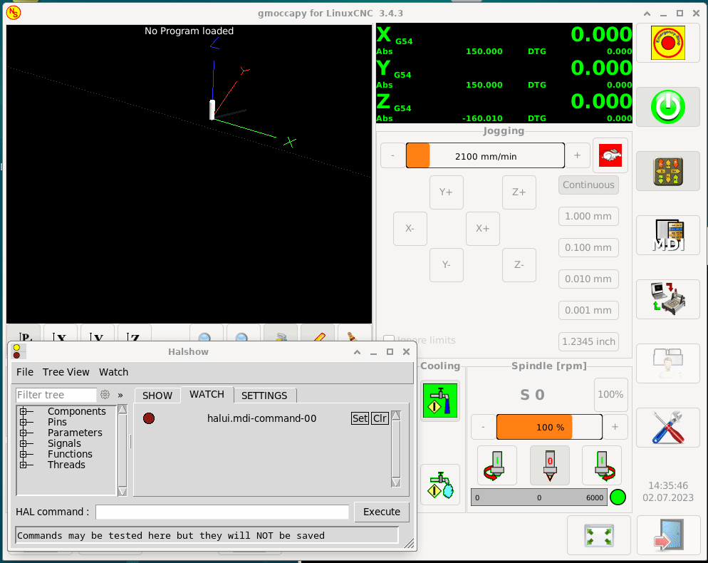

The problem is when I run halui mdi-command and immediately after python mdi-command.
Video:
In the video you can see that command.wait_complete() does not wait for halui to complete its commands. It will run python commands and thus LCNC will fall into an error.
I would like to ask for your help, or at least for your opinion, if you also think that this is a bug that should be fixed.

Replied by cmorley on topic Python command.wait_complete() does not wait for c++ halui commands
IIRC wait complete asks for command's next available serialized id number.
It then decides the command is done when that id number (or higher) is send in the status message.
So wait complete only waits within the context of the python that called it.
I wonder if it's possible to request a command id number for the python command but the halui command actually runs first. Or some other out-of-sequence event.

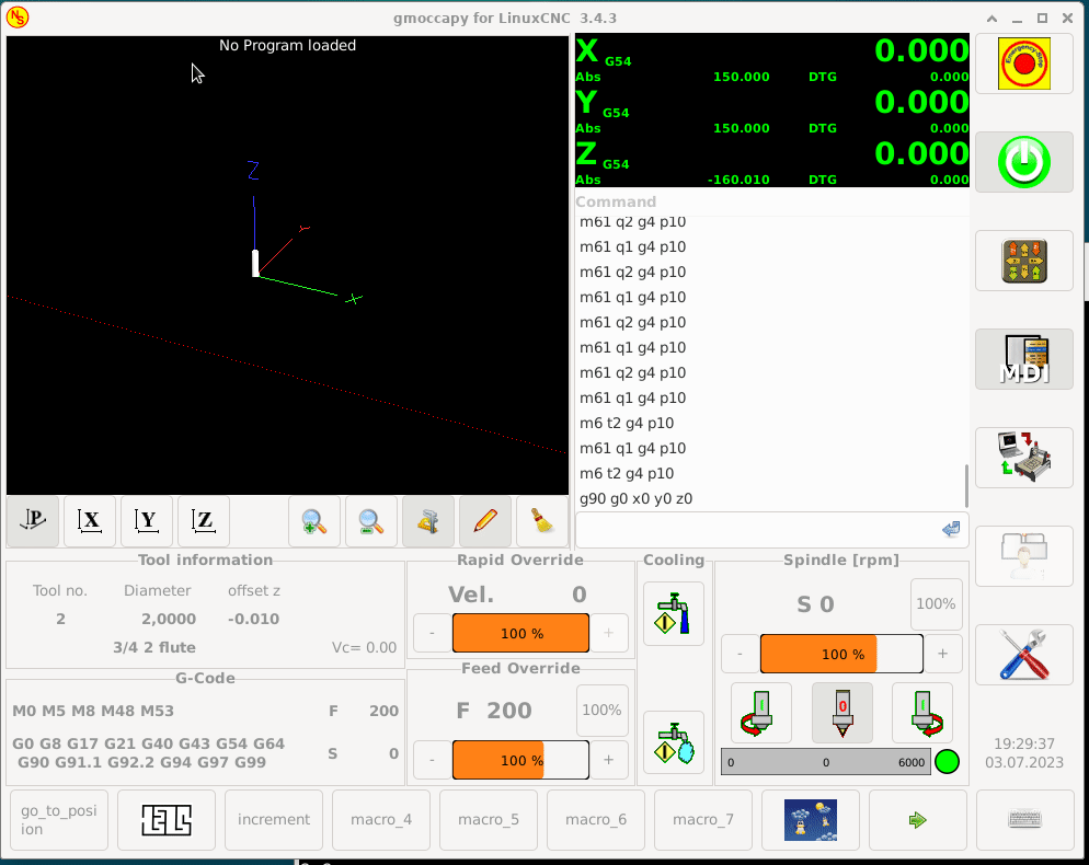

Did you mean such a test?
I modified file go_to_position.ngc :
Test number 1:
Run button Macro, then button Cooling.
I think it works as it should.
Test number 2:
I wanted to try the other way around, but if I press the Cooling button, the Macro button cannot be pressed.
Unfortunately Gmoccapy Macros are unusable for me.
I saw your question:
github.com/LinuxCNC/linuxcnc/issues/2561
Is this question related to this topic?
Replied by zz912 on topic Python command.wait_complete() does not wait for c++ halui commands
Hello Chris,Gmoccapy does have macro buttons though.
What behavior are you using halui for?
O<go_to_position> sub
G91
G1 Z-10 F200
O<go_to_position> endsub
M2Test number 1:
Test number 2:
