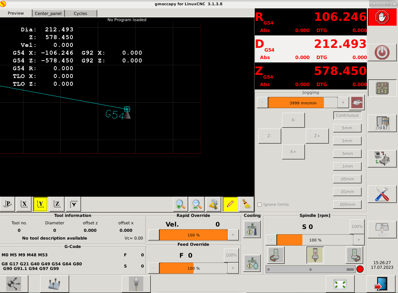

Hello
can anybody help me with small configuraiton problem please?
I really do not know what I am doing wrong, when I am adding any startup code to .ini file (just for exa.. RS274NGC_STARTUP_CODE = G7) and lcnc GUI freeze and this blank GUI happend pic.1. and cmd.txt what is behind it in the terminal.

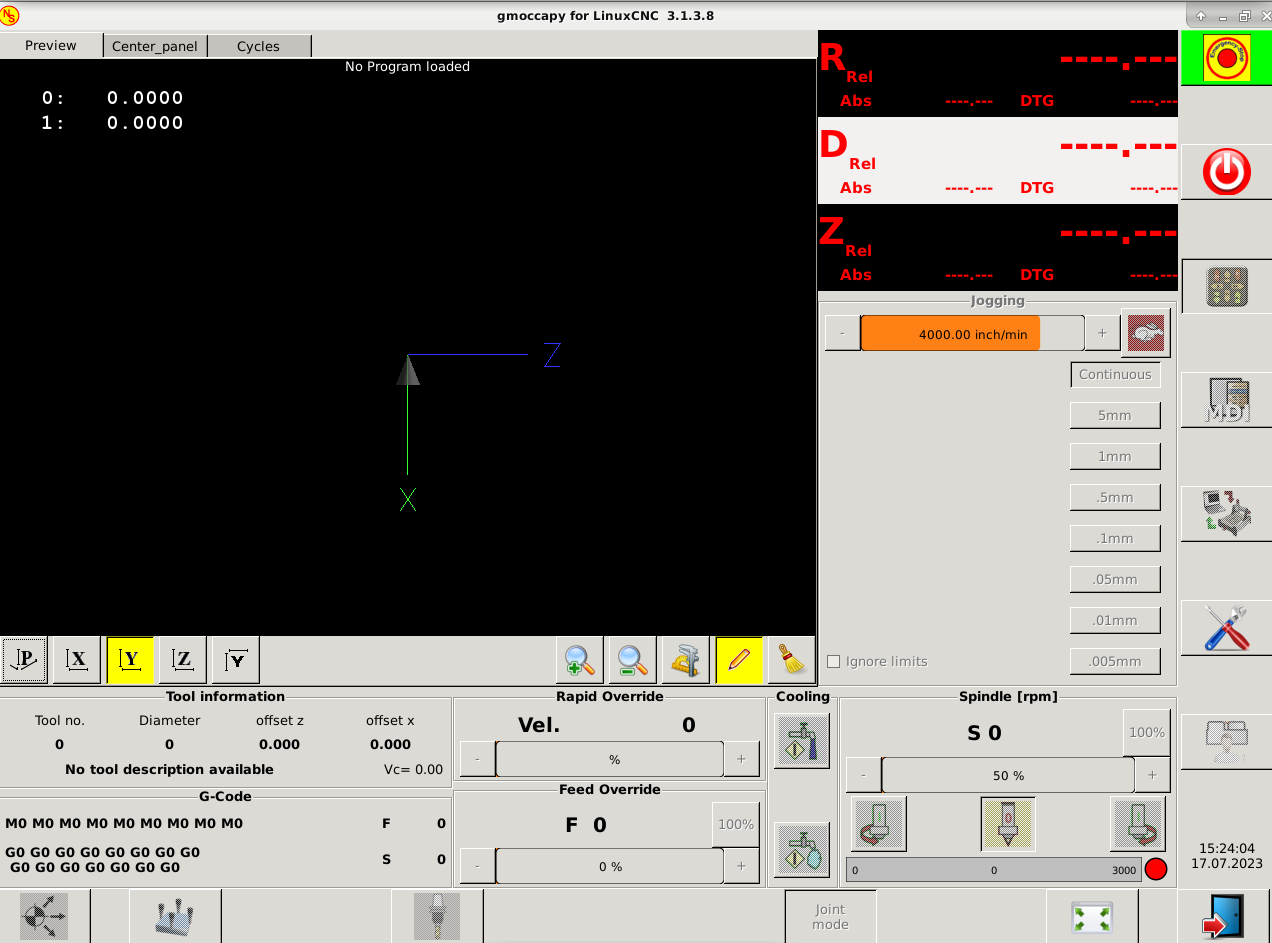

When I comment #RS274NGC_STARTUP_CODE = G7 everything works fine pic. 2 and cmdOk.txt what is behing it in terminal when everything is OK....
I found bug here
emc/task/emctask.cc 416: interp_error: Unknown word where unary operation could be
emc/task/emctaskmain.cc 3091: can't initialize interpreterbut what could I do? I found this issue

It sounds like there is a problem with the RS274NGC_STARTUP_CODE line. Possibly the wrong type of line-end character (so that the first letter of the next line is seen as part of the G-code string)

yes thanks for your idea.
I found that DOS endline and missing spacer between G64 and P0.01. I had just G64P0.01.
Regards Slav
