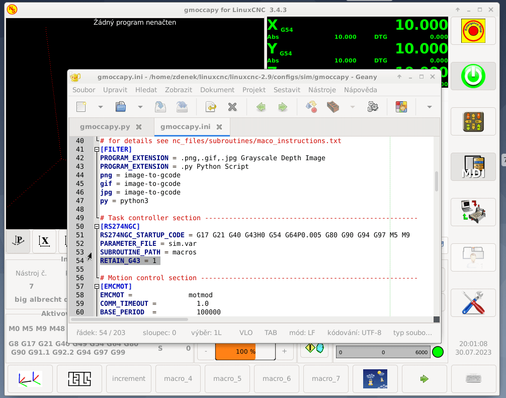

My startup code:
If I have:
After a toolchange, the Z correction takes 0.
If I have:
After a toolchange, the Z correction takes on the value of the last selected tool.
Code:
RS274NGC_STARTUP_CODE = G17 G21 G40 G43 G54 G64P0.005 G80 G90 G94 G97 M5 M9
If I have:
Code:
RETAIN_G43 = 1
If I have:
Code:
RETAIN_G43 = 0

Can confirm G43 is not retained after a consecutive commanded coordinate move. Preview shows visually but its not being added to coordinate moves

2 years 2 months ago #308206
by zz912
At the moment I answer: NO
I readed definition of RETAIN_G43 again:
linuxcnc.org/docs/stable/html/config/ini...sub:ini:sec:rs274ngc
I think the RETAIN_G43 function is for *.ngc file read only. After the *.ngc program ends, it is deactivated.
Therefore, RETAIN_G43 cannot be tested in MDI or MANUAL code.
Replied by zz912 on topic Retain G43
Am I using RETAIN_G43 correctly?
RETAIN_G43 = 0 (Default: 0)
When set, you can turn on G43 after loading the first tool, and then not worry about it through the PROGRAM. When you finally unload the last tool, G43 mode is CANCELED.
