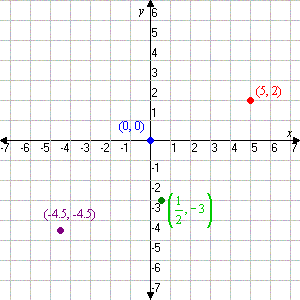

No not at all. Here is my gantry with X0,Y0 marked with a yellow cross
Why would 0,0 on a milling table be in any different position?
Here is a cartesian plane I referred to
Both my milling table and my plasma table fall in the top right hand side quadrant where all dimensions the tool moves from 0,0 are positive.
What chance have we got if we can't understand each other :)
However in relation to the gantry, if the operating position was on a side (which it  will be if you had a 90 metre long gantry like ones I have seen), the origin could well be in a different corner. That's why I say it needs to be in relation to where the operator runs the machine from.

12 Aug 2023 00:29 #277700 by blazini36
Replied by blazini36 on topic What is the "proper" zero origin
Because like I said 0,0 is referring to the XY coordinates of the tool not the table. It is never referring to the table ever. However on a standard mill you do not move the tool in X and Y, You move the table.
So on your router you move the head to the front left corner and your tool is at it's negative most X and Y so now call that 0,0. Stick a square piece of stock on center of the bed, which corner of the stock is your tool pointing at? Every move your tool makes from that point is positive of zero
Now go to a milling machine. Move the table to the front left call that X,Y 0,0. Stick that same square piece of stock on the center of the table, which corner is the tool pointing at? With your mill's table to the left front corner are you telling me that you can move anything in the positive direction on X or Y? I hope not because you can't.
Moving the table left on a mill is the same as moving the head right on a router because in both cases the tool is moving to the right of the working surface

12 Aug 2023 04:57 #277716 by tommylight
Replied by tommylight on topic What is the "proper" zero origin
Blazini is talking about a moving table mill, Rod about a moving head mill!
So both are right. :)
