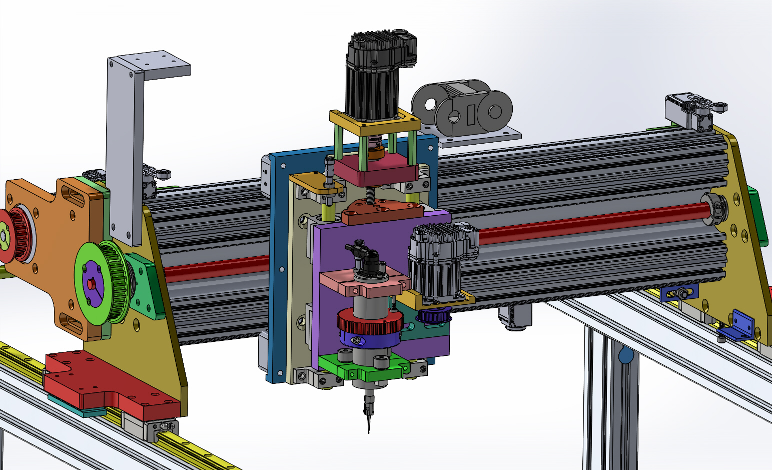

Back in 2020 I built an industrial automation system using a PLC and linuxCNC running on a ASRock Q1900 ITX.
forum.linuxcnc.org/38-general-linuxcnc-q...tion-machine?start=0
This machine turned out very well and continues to operate today. Now I am looking at another automation machine with the same basic concept of PLC control over the LinuxCNC environment. The criteria for any type of industrial automation is available replacement parts and reliability. The ASRock board has proven to be reliable using a 7i76e board and I could use it again in this next application.
My question is is there another more up to date motherboard available that runs LinuxCNC stable with a Mesa 7i76e? I just want to make sure I am using the latest proven hardware because this next machine may have a very long service life. I am open to any stable platform that should have long-term availability.

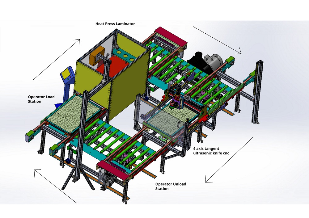

Sorry for not posting pics earlier. Things went really sideways during the pandemic. Thanks to everyone on the forum who helped make this project successful. Prior to this project I knew nothing of LinuxCNC.
The operator loads the raw material on one of the pallets that circulate around the system. They load raw material layers into a specific location on the pallet via the aid of a projected image from the overhead projector (code written in Python). Once they press start the pallet goes into the heat press and laminates the material (3 to 5 layers) and bonds them into one. Then it circulates into the CNC section where it is cut into the correct geometry. The operator of this machine has zero knowledge of LinuxCNC or any CNC operations. They simply select a product code via the touch screen and the software loads the correct image in the projector and then the software communicates to LinuxCNC using NML messages to load the correct g-code. It is fully automatic material infeed, run the g-code, automatic material outfeed, automatic homing on startup and rehoming on estop events. The Python software operates as a bridge between the PLC and LinuxCNC eliminating the need for the operator to know anything about CNC operation. I cannot say what the finished product is to protect my customer but I can say that it makes a medical device.
This next machine will process 20ft rectangular aluminum tubes for the RV market and be able to drill and pocket all 4 sides running a different g-code file for every side. It will also auto rotate and tube.
HH
HH
