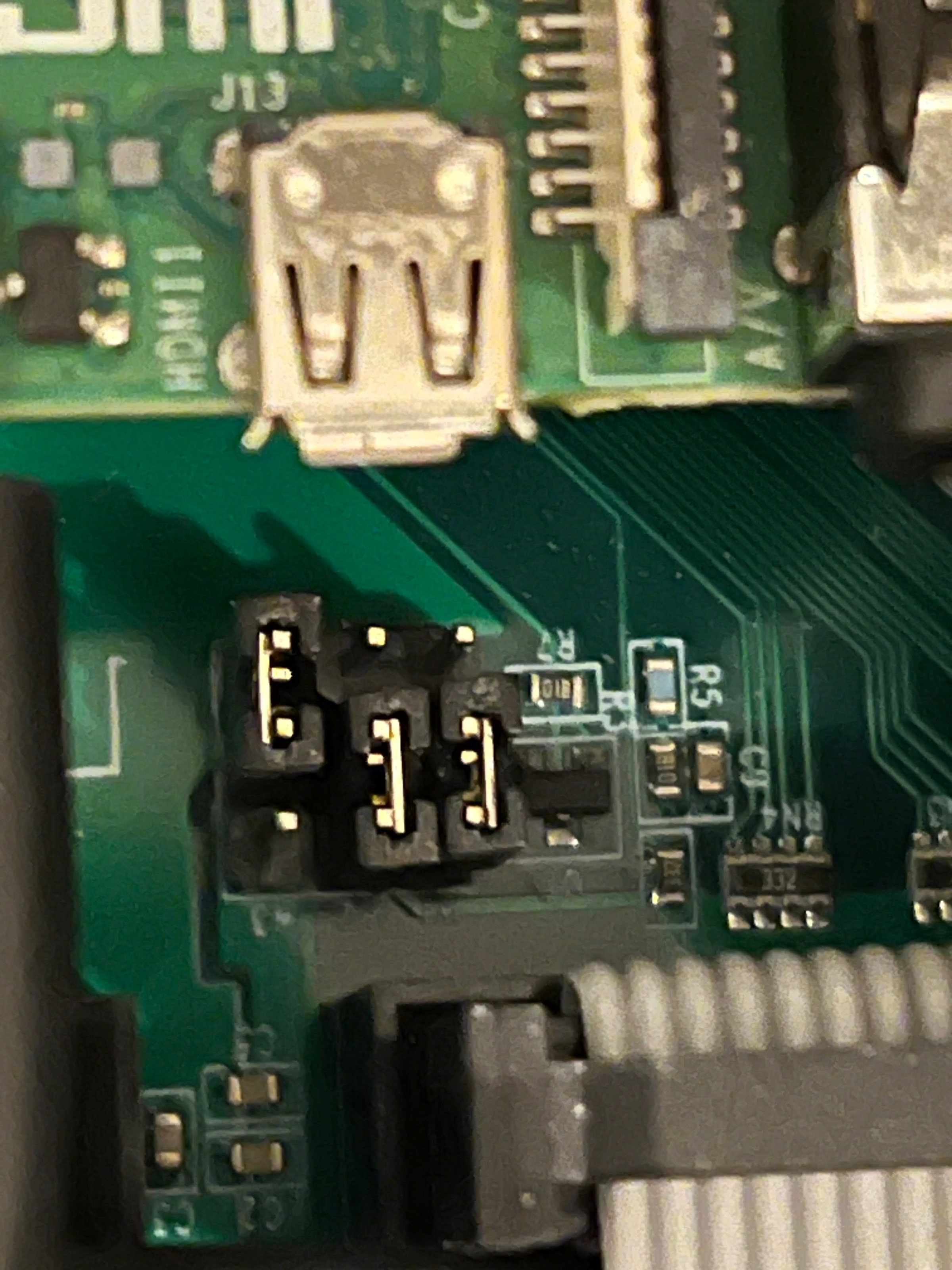

21 Aug 2024 20:50 #308359
by acondit
Replied by acondit on topic Converting a 7i76e config to 7c81/7i76 pair
1, Yes, the 7i76 has both 5V and field power
2. I believe that the flat cable is correct
3. The 7i76 is jumpered for power from the fpga card, however,
I am not certain of the 7c81 jumper w3. Is it supposed to be closer to the ribbon cable or farther from the ribbon cable.
The manual for the 7c81 says,
"Hardware setup jumper positions assume that the 7I98 card is oriented in an upright position, that is, with the Ethernet connector towards the left and the I/O connectors towards the right."
- Posts: 18122
- Thank you received: 5337
21 Aug 2024 21:11 #308362
Replied by PCW on topic Converting a 7i76e config to 7c81/7i76 pair
You have W3 down (you picture is upside down)
so not supplying 5V to the 7I76 You need W3 up
if the 7I76 is Jumpered to get cable 5V (7I76 W2 left)
W3 is one of the group of 3 jumpers under P1 but closest to
P2
P2
