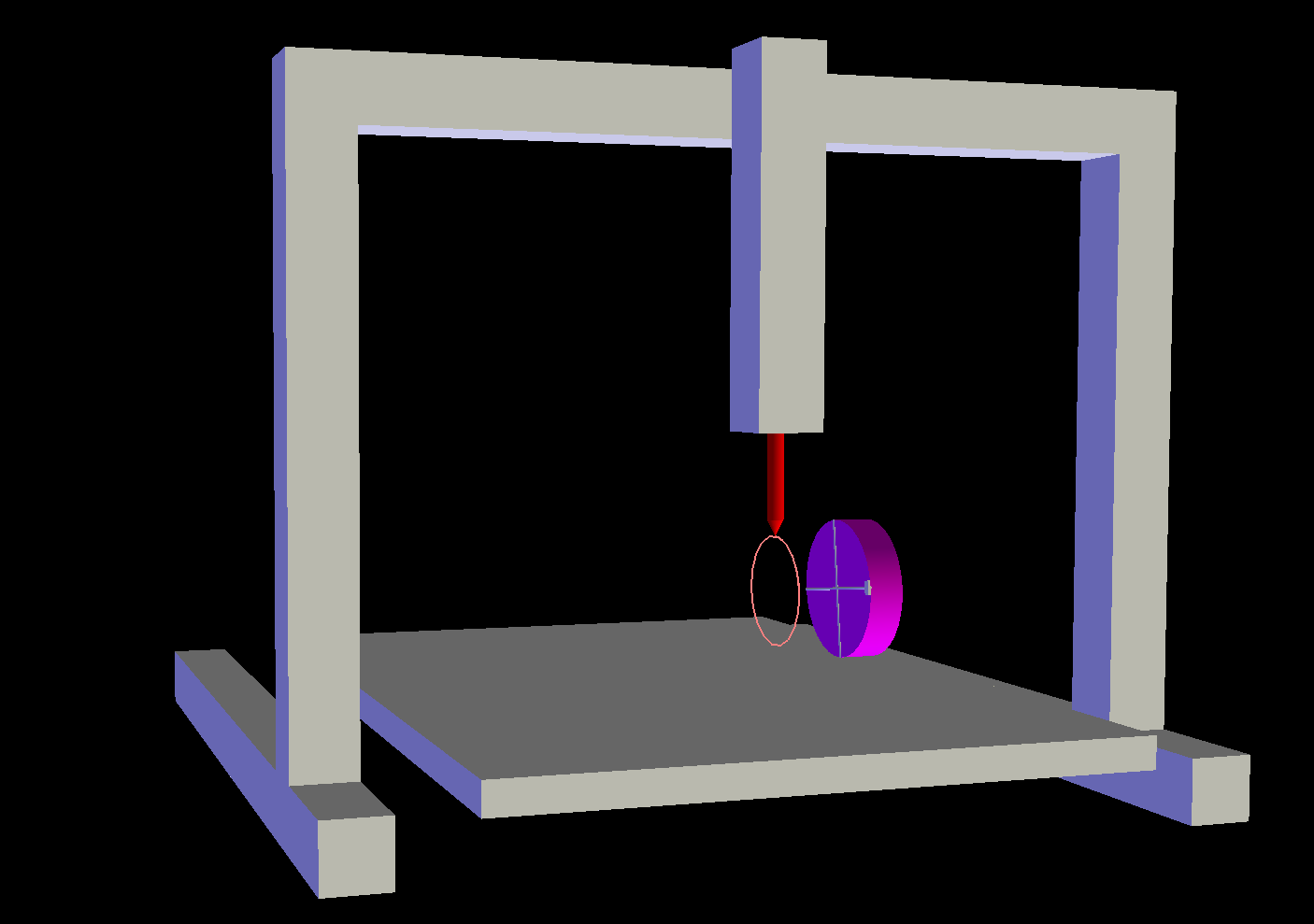

I am trying to engrave a cylinder. My idea was to program in X and Y and the machine convert the Y CAD data into angular position and rotate the axis.
I wrote a custom comp that also works in the halshow. A simple test was to move the Y axis 3.14mm with a diameter of 2mm and then rotate A 180 degrees.
ytoa.0.ypos is the input and ytoa.0.a is the angle converted.
With M100 / M101 it should be switched on and off.
A few questions remain unanswered and perhaps someone can help.
1. How can I forward the angle from ytoa.0.a to joint.3.motor-pos-cmd to avoid the following error?
2. My vismach is still bent. The A axis should rotate around itself and not in circle?
3. How can I clamp a workpiece there that will be engraved?
I attached my working folder.

Regarding the vismach model: Try changing this:
# A-axis move to X, Y, Z centerpoint
atable = Translate([atable],600,200,-200)
atable = HalRotate([atable],c,"ja",1,0,0,1)
To this (ie add the rotation before the translation):
I cannot test your config right now as I am away from my test setup.

30 Aug 2023 13:40 #279404 by chris@cnc
Replied by chris@cnc on topic wrap y to a axis
 Yes. One point less.
correct line is
atable = HalRotate([atable],c,"ja",1,1,0,0)

31 Aug 2023 02:42 #279452 by Hakan
Replied by Hakan on topic wrap y to a axis
I think it is cool if you can make this work. I'll keep watching.
31 Aug 2023 03:03 #279454 by Aciera
Replied by Aciera on topic wrap y to a axis
I try
halcmd unlinkp joint.3.motor-pos-cmd
halcmd net J3:pos-cmd ytoa.0.a J3_pid.command
but after 0,3mm i got position error. I guess the limit3 will not help
I'm not sure partially because I'm really not very clear on how the position command and feedback is handled in a sim config but I feel that using a custom kinematic component would make things a lot simpler since you don't need to link and unlink command signals and the a-axis motion would still be handled in the motion planner. It probably can be done in a hal component but to me it seems somehow like reinventing the wheel.
Anyway the attached config contains a modified vismach model with dynamic work piece diameter which you may find useful.
