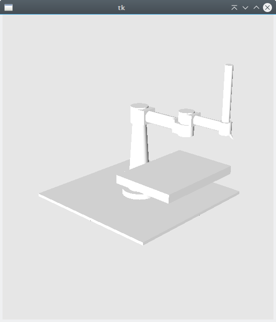

You dont understand me.
My color of parts is white:
a_kryty = Color([1,1,1,1],[a_kryty])
But in visualization it has blue (or purple) "shadow".
Look at:
linuxcnc-2.9/configs/sim/axis/vismach/scara/scara.ini
Look at:

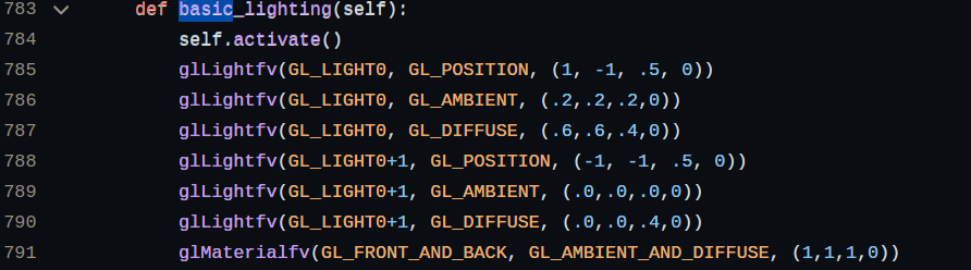

Ah, I see. Yes you can adjust that in these lines of 'vismach.py':
I haven't tried them all but if you change line 790 to this:
glLightfv(GL_LIGHT0+1, GL_DIFFUSE, (.4,.0,.0,0))
You will change the blue to a red shadow. (So adjust to your needs)
[edit]
Note there are two diffuse light sources ('GL_LIGHT0' and 'GL_LIGHT0+1') so you may have to adjust both.
[edit]
