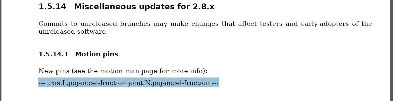

08 Sep 2023 13:24 #280282
by Roguish
Replied by Roguish on topic Using Lower Accels While Jogging
The following user(s) said Thank You: Aciera, Beef

08 Sep 2023 17:26 #280296
by Beef
Replied by Beef on topic Using Lower Accels While Jogging
Well that's a hell of a lot cleaner. I saw this on the Discord from you and intended to cross-post here for whoever comes with a similar question, but you beat me to it.
Thanks for pointing this out.
