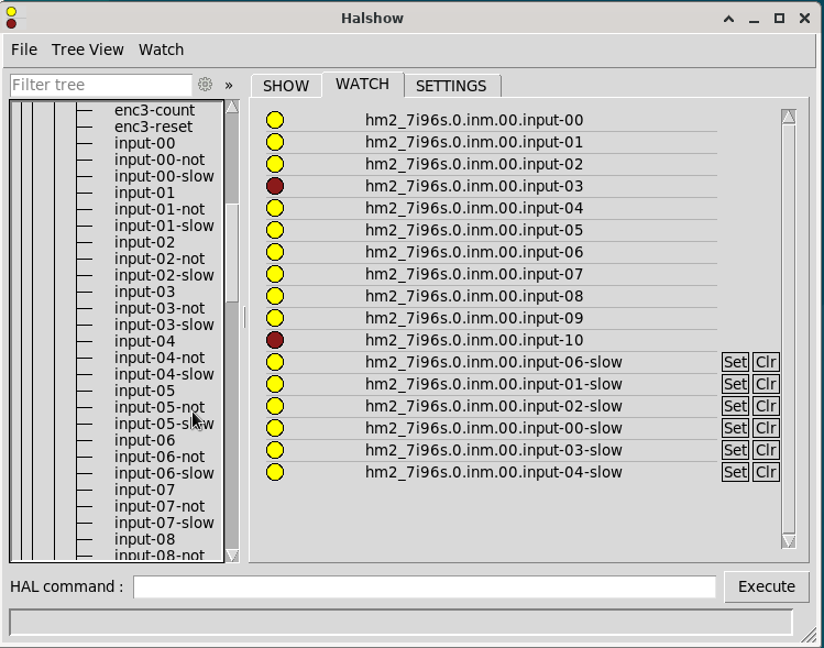

My Board : 7i96s + 7i77
I wiring input signal of ATC 5 wire to 7i96s on input 00-04 .
I open hallshow and click for show this :
hm2_7i96s.0.inm.00.input-00
hm2_7i96s.0.inm.00.input-01
hm2_7i96s.0.inm.00.input-02
hm2_7i96s.0.inm.00.input-03
hm2_7i96s.0.inm.00.input-04
I'm not action or move anything but circle status in halshow will trick between yellow and red .
I think it's noise right ?
I try call hm2_7i96s.0.inm.00.input-00-slow for show in list, back of it's I click set.
input status look good no blink in no action and show correct when change position.
I have question,
In file.hal how to call for use input-00-slow
now I use this net atc-enc-1 motion.digital-in-11 <= hm2_7i96s.0.inm.00.input-00
seccond , How long time when use input-00-slow time for detect signal , Because I use motor induction gear for rotation ATC, I fear if long time for detect signal maybe tool will over position .

Yes it is noise or interference, use shielded cable or twisted pair for sensors.
Is this with spindle on or off?
If off, then you will have much more issues when spindle is on, so this needs to be fixed in hardware, not software.

this is spindle inverter standby stage, No run .
Can't for use hm2_7i96s.0.inm.00.input-00-slow ?

Default inm digital filter settings are 250 usec for fast time
and 25 ms for slow time:
The fast and slow digital filter times are set by these parameters:
hm2_7i96s.0.inm.00.slow_scans ( default is 500 so 25 ms )
hm2_7i96s.0.inm.00.fast_scans ( default is 5 so 250 usec )
hm2_7i96s.0.inm.00.scan_rate ( default is 20000 Hz = 50 usec per scan)

If i want input-00 to 04 for slow scan ( 500 so 25 ms )
and want input-05 to 11 for fast scan ( 5 so 250 usec )
how to type in file hall ?
Please type for example code for guild me

No, the timing parameters are global (for all inm.00 pins)
To set inputs 00 through 04 to "slow" you would:
setp hm2_7i96s.0.inm.00.input-00-slow true
setp hm2_7i96s.0.inm.00.input-01-slow true
setp hm2_7i96s.0.inm.00.input-02-slow true
setp hm2_7i96s.0.inm.00.input-03-slow true
setp hm2_7i96s.0.inm.00.input-04-slow true
( The default is "fast" for all pins at startup )

Thank you very much, Tomorow I will try for this solution (set slow) for 5 wire encoder .
