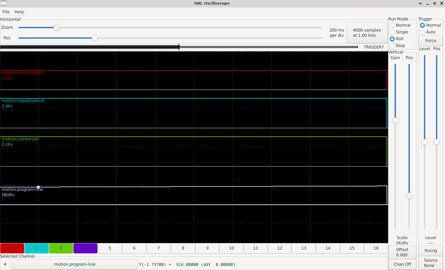

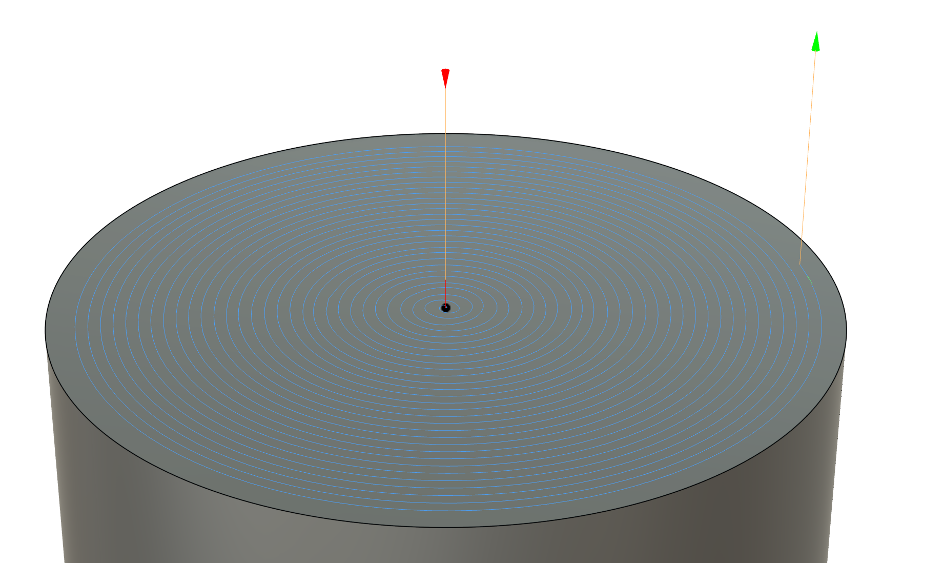

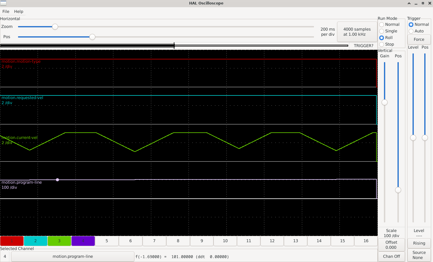

I'm running into a problem where a toolpath that should run at a relatively constant feedrate is experiencing unexpected acceleration and deceleration if the toolpath is generated using the Smoothing option, which is a Fusion CAM feature that replaces groups of short G1 line segments in the toolpath with G2/G3 arcs. I've been in the habit of using this toolpath feature because I'm moving from a GRBL-based controller and using Smoothing was important on Adaptive and other nontrivial toolpaths because GRBL would stall streaming the huge amount of gcode produced with short G1 line segments, but handled a smaller number of G2/G3 arcs just fine.On LinuxCNC, I'm actually seeing the opposite behavior.
I've put together a demonstration of this issue using a spiral toolpath (see SpiralToolpath.png)

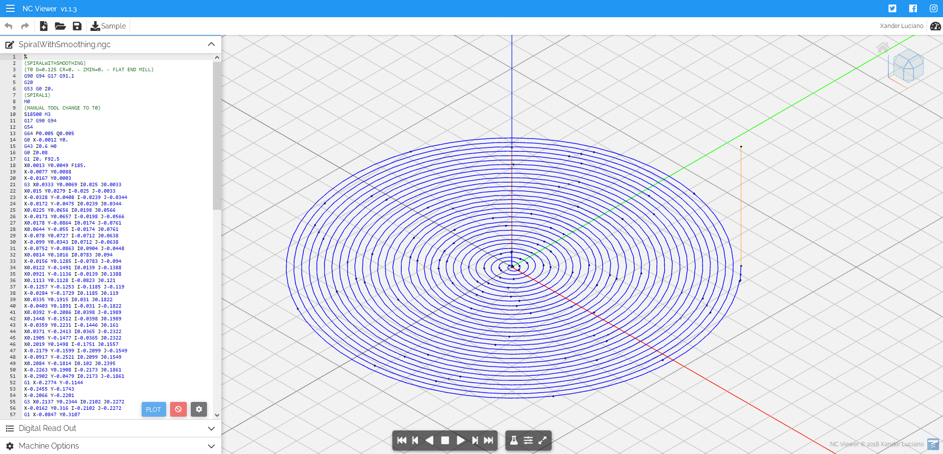

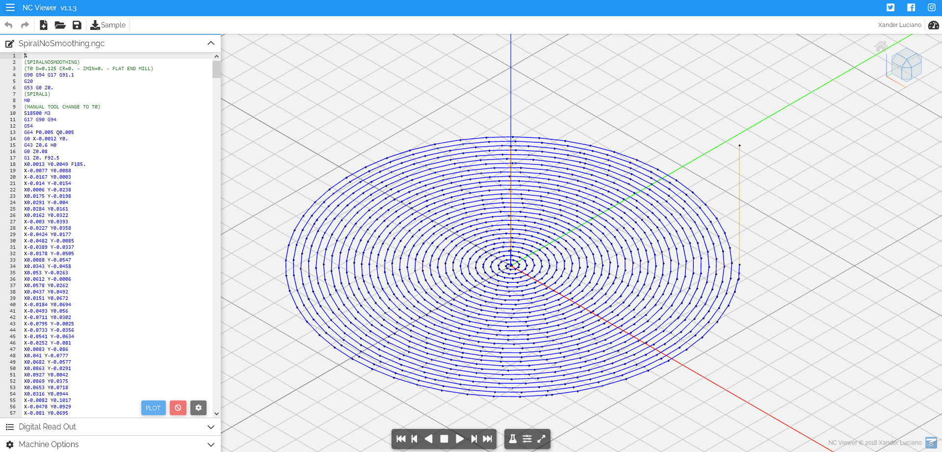

I generated the tool path with and without smoothing enabled:
SpiralNoSmoothing.ngc
SpiralWithSmoothing.ngc
When the path without smoothing (just lots of short G1s) is run, the velocity is fairly constant toward the outside of the toolpath (around line 900 in SpiralNoSmoothing.ngc). See SpiralNoSmoothing-halscope.png.
When the path WITH smoothing (mostly consecutive G3s) is run, the velocity goes up and down each time a new line of gcode is hit - this is especially noticable about 3/4 of the way through the file, around line 100 in SpiralWithSmoothing.ngc. See SpiralWithSmoothing-halscope.png.
I’ve been using Fusion 360 and smoothed toolpaths for several years now with a grbl controller and I haven’t had any issue with it, but for some reason LinuxCNC is behaving as if each back-to-back G3 isn’t tangent to the previous one, requiring a deceleration between lines of gcode. But, the same toolpath without arcs is handled a lot better by the trajectory planner.

One thing I did try was to hand-write a gcode file with a series of circular G2 paths that had different center points but were otherwise tangent between them, and with G64 P0 Q0 it behaved as expected - it followed the path exactly, and it didn't slow down between arc segments, so I think this probably has to do with Fusion 360s smoothed series of arc segments not being tangent to each other... but I would assume that increasing the path following tolerance with G64 P0.010 Q0.010 or even G64 P0.1 Q0.1 would allow it to round off the junctions between the arcs and keep the speed up, but it doesn't seem to be doing that when I've tried it.
