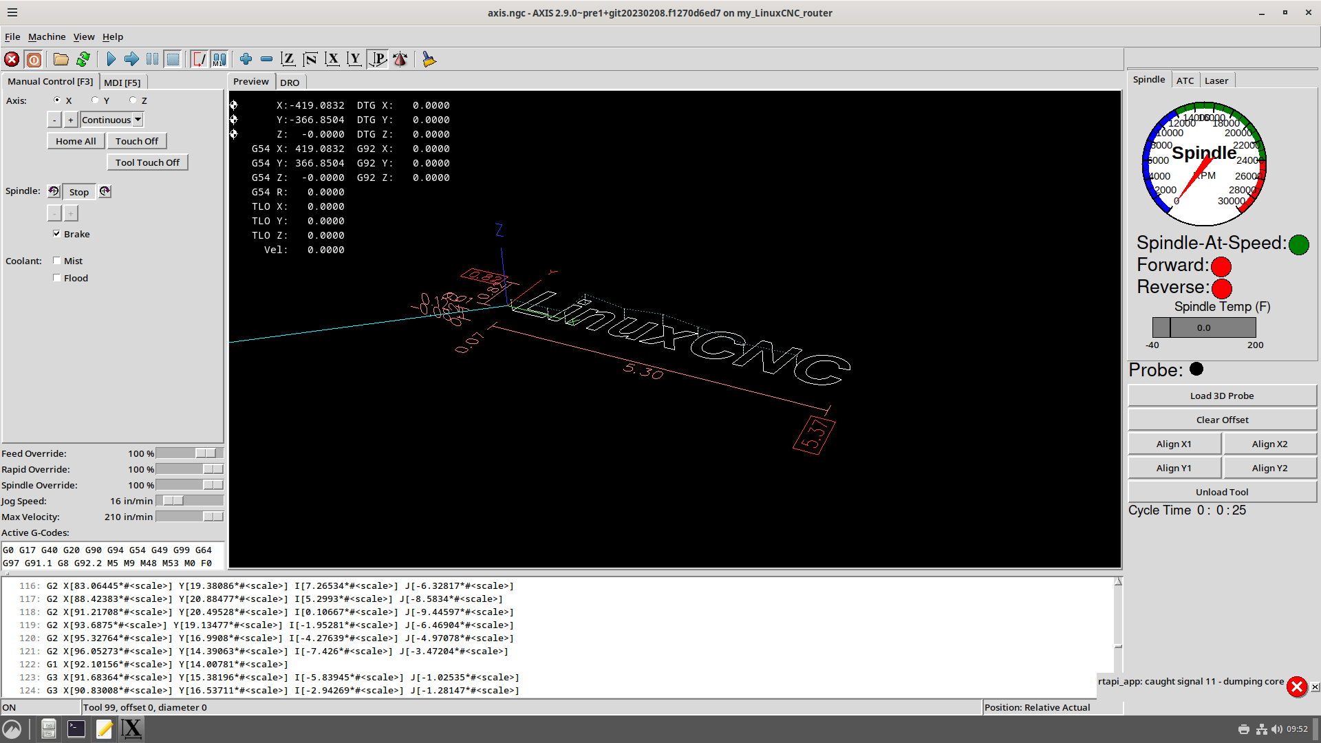

i changed to tool # 99 (3D probe) and as soon as the manual change routine returned, i got this error. it locks up LinuxCNC so all i can do is exit out and restart it.
if config related, my configs are all at: github.com/travis-farmer/linuxcnc
I am running Debian 12, with the debian 12 supplied RT kernel, and LinuxCNC 2.9 Pre 1 from the debian 12 repo.

major idiot error...
old comp file:
github.com/travis-farmer/linuxcnc/blob/7...0da8/rpmlimiter.comp
fixed comp file:
github.com/travis-farmer/linuxcnc/blob/master/rpmlimiter.comp
i think tool # 99 was calling beyond what i had configured the array "tool_max" to be...
dumb... dumb... idiot!
old comp file:
fixed comp file:
