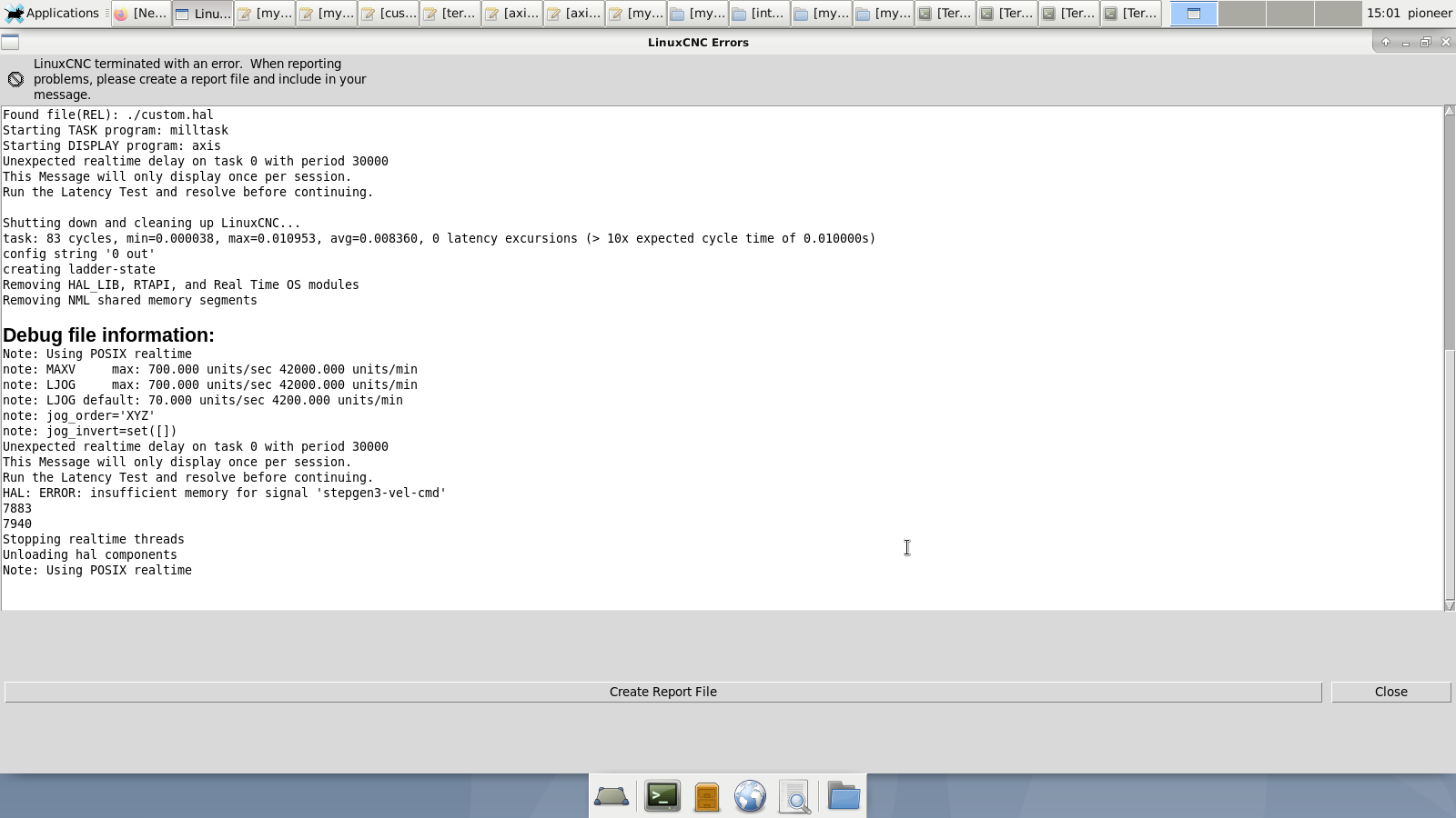

I created a configuration that contains a lot of hal components.
Previously I was using Debian Wheezy 2.8.4, everything worked fine.
but when I updated to Debian Buster 2.8.4 but an error like this appeared...
how do i increase hal memory??
I've read posts with the same problem, but I don't know how to do it
forum.linuxcnc.org/10-advanced-configura...-signal-pin?start=20

Replied by Aciera on topic How to modifying the HAL_SIZE in linuxcnc (Insufficient memory PROBLEM)
If I understand the linked thread correctly then you can only increase the hal memory if you compile linuxcnc on your computer (aka a RIP or run-in-place installation).
If you installed linuxcnc using a package or an ISO image you cannot increase hal memory size.
So the question is: How did you install Linuxcnc?

22 Sep 2023 14:38 #281384
by fery15sty
Replied by fery15sty on topic How to modifying the HAL_SIZE in linuxcnc (Insufficient memory PROBLEM)
I installed Linuxcnc using an ISO image.
OK, I will try to use the RIP installation method.
Thank you very much
Thank you very much

Replied by tommylight on topic How to modifying the HAL_SIZE in linuxcnc (Insufficient memory PROBLEM)
Just the quick start part, 1.1, most probably.
Running this should create a folder named 'linuxcnc-dev' containing the source files:
$ git clone github.com/linuxcnc/linuxcnc.git linuxcnc-dev
Run these to get the most up-to-date packages
sudo apt update
sudo apt upgrade
Then install these dependencies (not all may be needed and/or you may need to install others but these should give you a good start )
sudo apt install automake
sudo apt install libudev-dev
sudo apt install libusb-1.0-0-dev
sudo apt install glib
sudo apt install libglib2.0-dev
sudo apt install libgtk-3-dev
sudo apt install yapps2
sudo apt install intltool
sudo apt install tcl8.6-dev tk8.6-dev
sudo apt install bwidget
sudo apt install tclx
sudo apt install libreadline-gplv2-dev
sudo apt install libxmu6
sudo apt install libxmu-dev
sudo apt install asciidoc
sudo apt install libmodbus-dev
sudo apt install libgtk2.0-dev
sudo apt install libboost-python-dev
sudo apt install python3-gi
sudo apt install libpango-1.0-0
then do
$ cd linuxcnc-dev/src
$ ./autogen.sh
$ ./configure --with-realtime=uspace --disable-build-documentation-translation --enable-non-distributable
Note there may be errors here about missing dependencies. If unsure post the error here.
If the above command completed without error then do:
$ make && sudo make setuid
This will take a while. If it finishes without errors then do
$ cd ..
On a rip installation, every time you open a new terminal you need to set the source to start linuxcnc
$ source scripts/rip-environment
then you can see if it works
$ linuxcnc
[edit]
Use the more current doc here:
linuxcnc.org/docs/devel/html/code/building-linuxcnc.html
