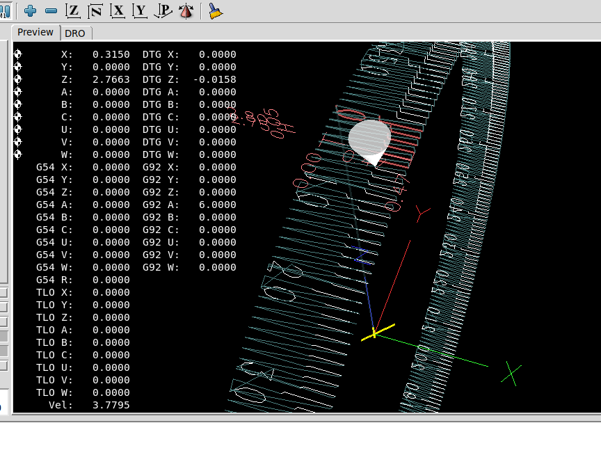

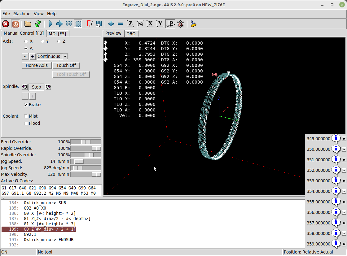

03 Oct 2023 01:21 #282112
by scotth
2.9 part display Axis was created by scotth

Rod, I was running the version downloaded from Debian server 9/30/2023.
I included the program to see if anyone else has the problem. I have no idea if it is me or the software. Likewise, I see it on Bookworm and Linux Mint Debian Edition 6.

03 Oct 2023 15:04 #282166
Replied by Aciera on topic 2.9 part display Axis
In version 2.9 and above:
In the DISPLAY section of your ini file:
GEOMETRY = A!XYZ
Works for me:
From the docs: linuxcnc.org/docs/2.9/html/config/ini-config.html
GEOMETRY = A!XYZ
Works for me:
Experimental: If the exclamation mark (
) character is included in the GEOMETRY string, display points for A, B, C rotations respect the X, Y, Z offsets set by G5x, G92 codes. Example: Using!for a machine withGEOMETRY = !CXZ. This provision applies for liveplots only — G-code previews should be done with zero G5x, G92 offsets. This can be facilitated by setting offsets in programs only when task is running as indicated by #<_task> == 1. If nonzero offsets exist at startup due to persistence, offsets should be zeroed and preview reloaded.[TRAJ]COORDINATES=XZC

03 Oct 2023 15:23 #282168
by scotth
Replied by scotth on topic 2.9 part display Axis
Thank you Aciera.
This was well hidden.
11 Experimental: If the exclamation mark (!) character is included in the GEOMETRY string, display points for A, B, C rotations respect the X, Y, Z offsets set by G5x, G92 codes. Example: Using GEOMETRY = !CXZ for a machine with [TRAJ]COORDINATES=XZC. This provision applies for liveplots only — G-code previews should be done with zero G5x, G92 offsets. This can be facilitated by setting offsets in programs only when task is running as indicated by #<_task> == 1. If nonzero offsets exist at startup due to persistence, offsets should be zeroed and preview reloaded.
I will try it this afternoon. It only appears to exist in later versions of 2.9

04 Oct 2023 04:59 #282245
by scotth
Works like a champ!
Thanks again.
Scott
