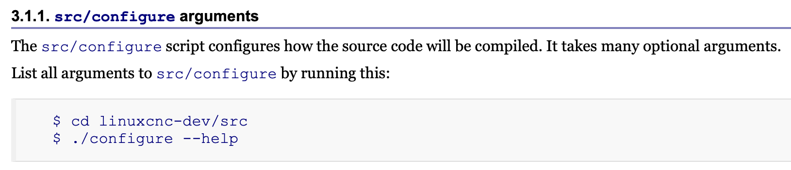

But its not listed in the docs for RIP
linuxcnc.org/docs/devel/html/code/buildi...ing_for_run_in_place
Last edit: 04 Oct 2023 07:22 by rodw.
- phillc54
- Posts: 5711
- Thank you received: 2100
04 Oct 2023 17:33 #282323
by phillc54
Replied by phillc54 on topic configure flag --enable-toolnml gives error during compilation
Not many arguments are listed but it does show how to list them:But its not listed in the docs for RIP
