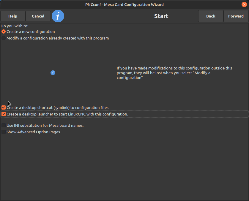

Can you tell me then, I did as you said, but when I try to create a configuration, it is created in the linucnc folder, but it is not added to the desktop, what could be the problem?
I think that maybe the type of interface is to blame and you need to put another one and then display everything, am I thinking correctly?
- Posts: 21901
- Thank you received: 7465
11 Oct 2023 12:37 #282740
Replied by tommylight on topic Problem with installing LinuxCNC
