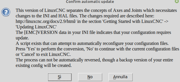

I have an old 2.9 ini file ... but uses from 3 years as JA ini file .... now I use the same INI on 2.10 pre0 install ... and I have everytime these warning (pherhaps yes or no make nothings) .... see image:

Usually the script does do a backup if you click yes.
Open the ini file, it will have a version number, so if it already has joints/axis stuff, just change that number and try again.

I know these but nothing chage .... my VERSION is 1.2, but 3.6 have same unfortunately result ... tomorrow try again and post image problem.

@ ALL .... previously (with my last Lcnc 2.9 pre0) I change these section on ini file:
[EMC]
VERSION = 1.x
from 1.0 to 1.2 value (previous request of JA). So now think need a bigger number because upgrade from 2.9 pre0 to 2.9.1 ....
And obtain at every start these messages:
but right value is :
[EMC]
VERSION = 1.1
In these way messages disappear at all ....

03 Nov 2023 08:41 #284451
Replied by tommylight on topic why in ne Lcnc2.10 have JA warning messages continuosly? how to stop?
I thought it was 1.1 but i was not sure, have not edited config files in a while now.
Thank you for reporting back.
