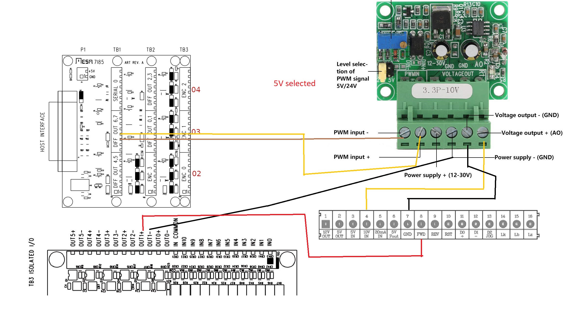

I have a A2 Series VFD which is controlled by 0 - 10V input.
The good guy Mister PCW from this forum here made me a specific bitfile which turned one stepgen on the 7i85s into a pwmgen.
The pwm signal is convertet into a 0-10V signal by a small converterpcb.
But for the sake of it, I can´t figure the hal pinout in relation to my wires on the 7i85s out anymore.
7i85s Wires are: TB1, Diffout 6,7, Pin 9 and 12

But the spindle will not start.
Linuxcnc starts with no errors.
I can´t seem to find the correct pins with the multimeter either.
Could someone help me or point me in the right direction?

Replied by PCW on topic Mesa 7i96 + 7i85s PWM VFD Control
The PWM pins would be 7I85S TB1.11 and TB1.12
It might be helpful to start LinuxCNC, enable the spindle
and set the spindle speed to to say 1/2 of full speed, then
run this command from a terminal window:
halcmd show all | grep pwm
and post the results here

If I measure the TB1 Pins 11 and 12 on the 7i85 I get constant 4.90 volts. If I stop the spindle I still have 4,90 volts.
If I understand correctly from the Halcmd show it means that the pwm gen does not enable because there is no spindle enable signal?! am I right? But why are there 4.90 volts then.
Then I played with the spindle override slider to see if the spindle would change rpm. It doesn´t. As soon as I pull the slider to 0% the spindle stops. When I put it to 1% the spindle goes to maximum rpm. But I think what Is happening here is that the slider turns off the spindle enable pin when at 0% if I´m correct.

I think you need to invert the PWM output:
setp hm2_7i96.0.pwmgen.00.out0.invert_output true

I inverted the output in my hal file. The voltage is still staying at 4.90 volts. Spindle ramps up to max rpm no matter if I adjust the spindle override slider or if I change the rpm in the MDI.
Halcmd show states as follows now:

I just came back from a business trip yesterday and I made a little wiring scetch to show how everything is wired.
I only seem to get 5v to the pwm output. I can´t think of any error.
- Posts: 18122
- Thank you received: 5337
12 Nov 2023 05:36 #285158
PWM- should go to GND (7I85S TB1 pin 10)
PWM+ should go to 7I85S pin 11

Good Day, Sir!
I just gave your tip a try and It didn´t work.
Spindle starts but I can not alter the RPM. It still runs on max rpm. On the pwm port there are still 4.95V.
Is there a way I can program somwhere else a pwm port on the 7i96 or so?
I don´t realy need quick response pwm thing since I don´t index the spindle or something like that.
Greetings and thank you.
