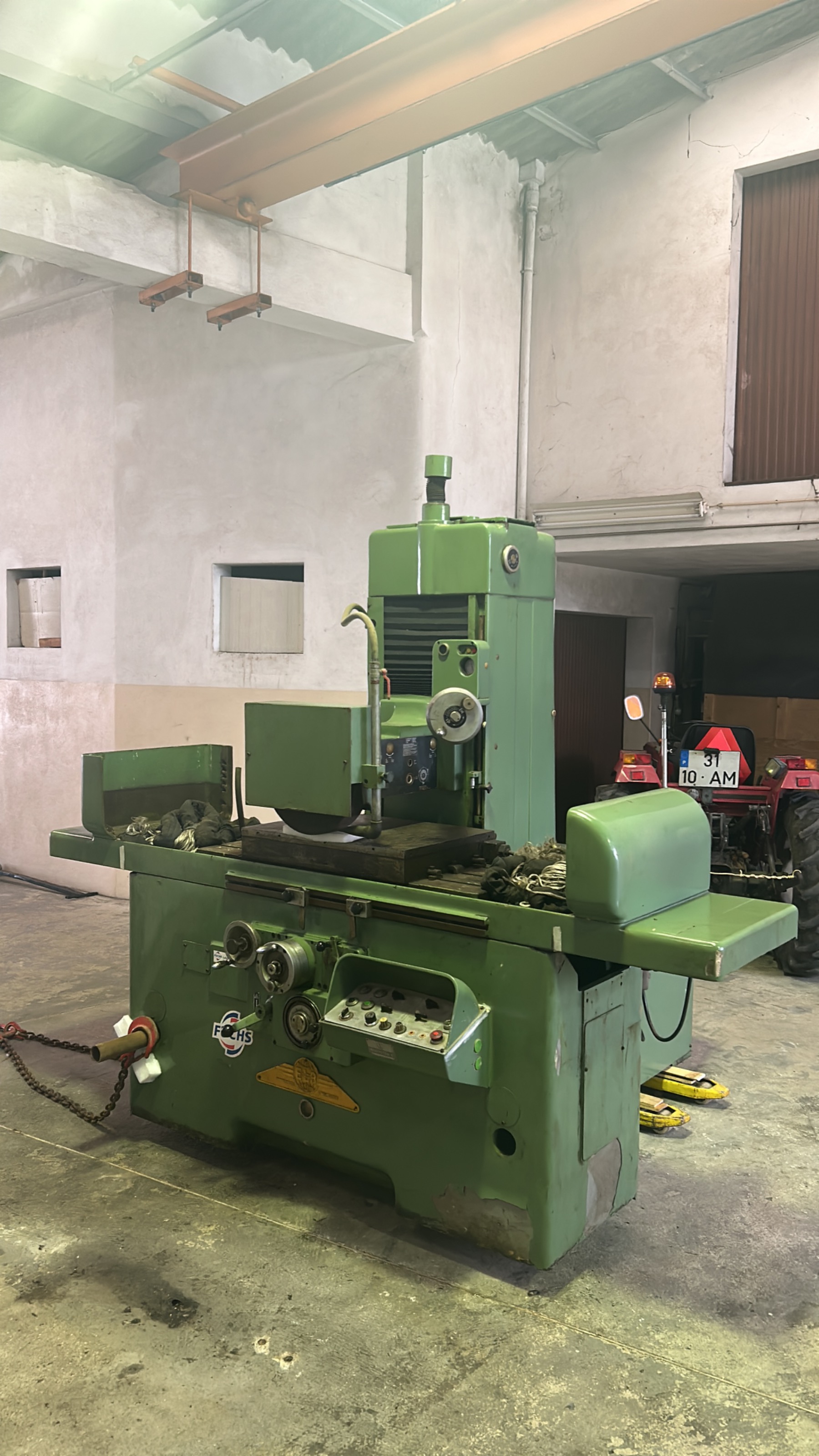

Hello.
I have purchased a 50 year old machine (here we go again....) with the intent of retrofitting it.
The machine is a horizontal surface grinding machine with hydraulic axis, driven by directional valves.
The Z axis lowers up/down hydraulically, and it is manually adjusted to the desired height with high precision.
The X axis moves back and forth in order to grind the part, and the Y axis can also move back and forth.
My intent is to install linear scale encoders on them, feed them to a mesa board, and drive the hydraulic valves with directional control only. I would then insert g-code and the machine would work by itself.
The linear scale encoders are simple, and connecting them to linuxcnc is too. I will be buying a 7i95 or 7i96s with an additional encoder board.
The main issue i see, right before starting this project, is the need to send the directional signal to the valves, in order to tell the system to move.
- I use the stepgen direction pin to drive the valves, as it assumes negative voltage for negative direction and positive voltage for positive direction. I would then completely ignore the pulse step generator. Or is there a better way to do this, with chargepump or some other function?
- I need to allow a bigger following error, as there is no problem to this: i dont have any issue in moving a bit more than needed in X/Y, as this machine is only a surface grinder, and all the parts in the worktable will be surfaced at the same height.
I will be posting pictures as i progress with this retrofit, painting the machine, making the HMI, etc.
I like the way it works hydraulically, as the axis move quite fast and smoothly, without a sound, even though the machine is really old, so i wouldn't want to install servos/ballscrews.
Any suggestions will be highly appreciated.
Thank you guys!

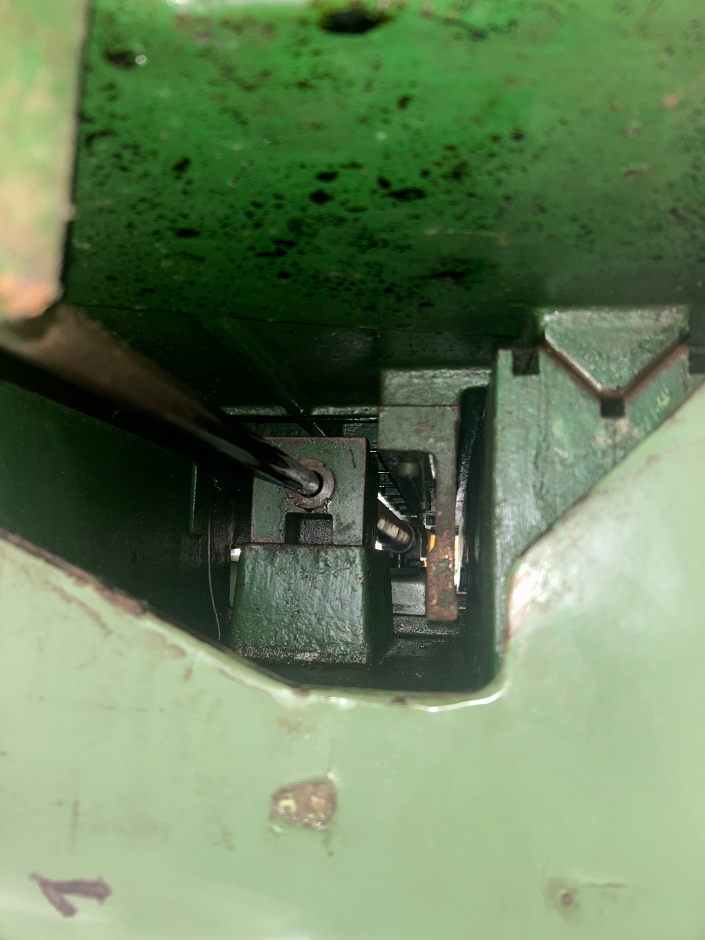

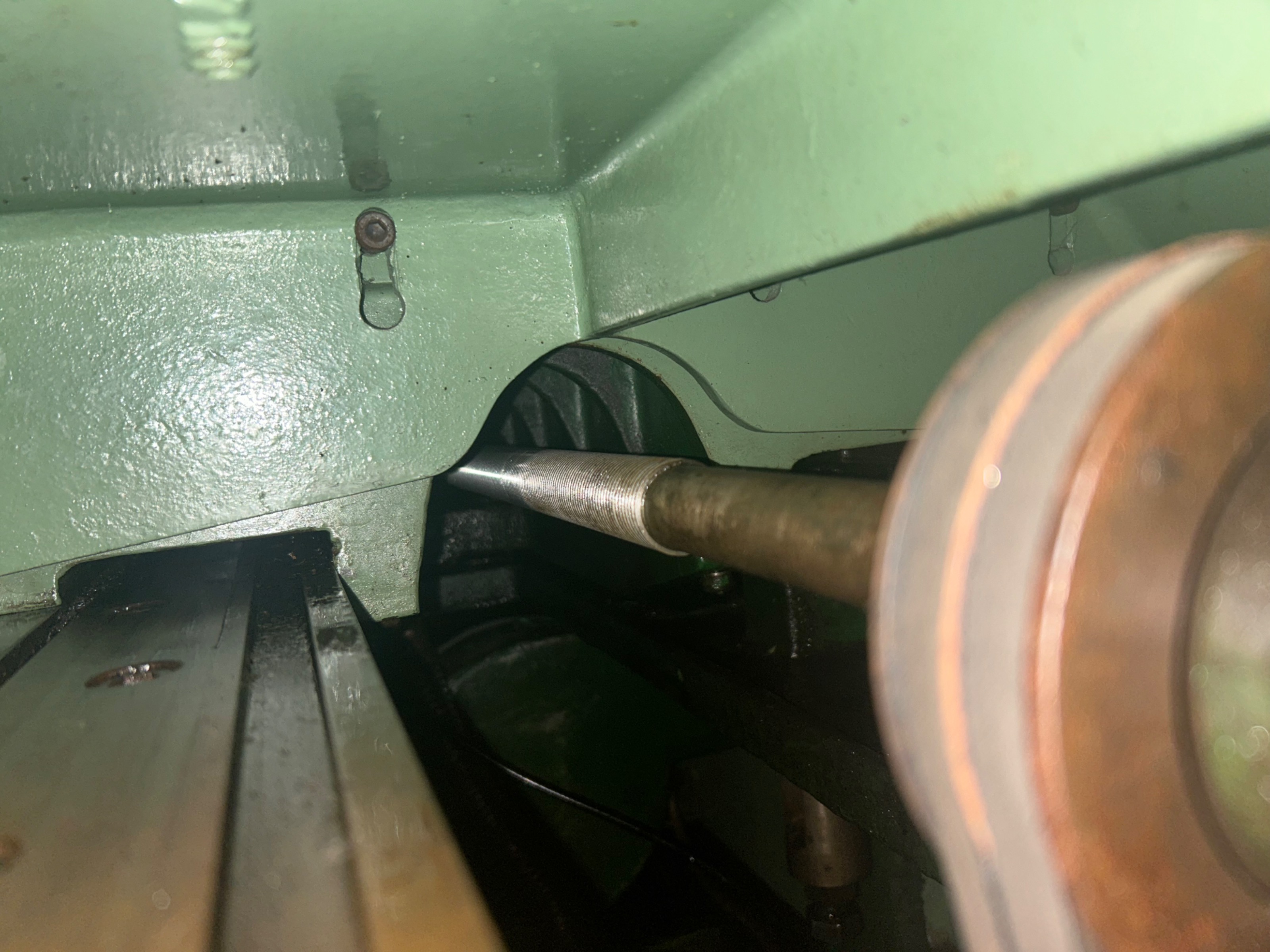

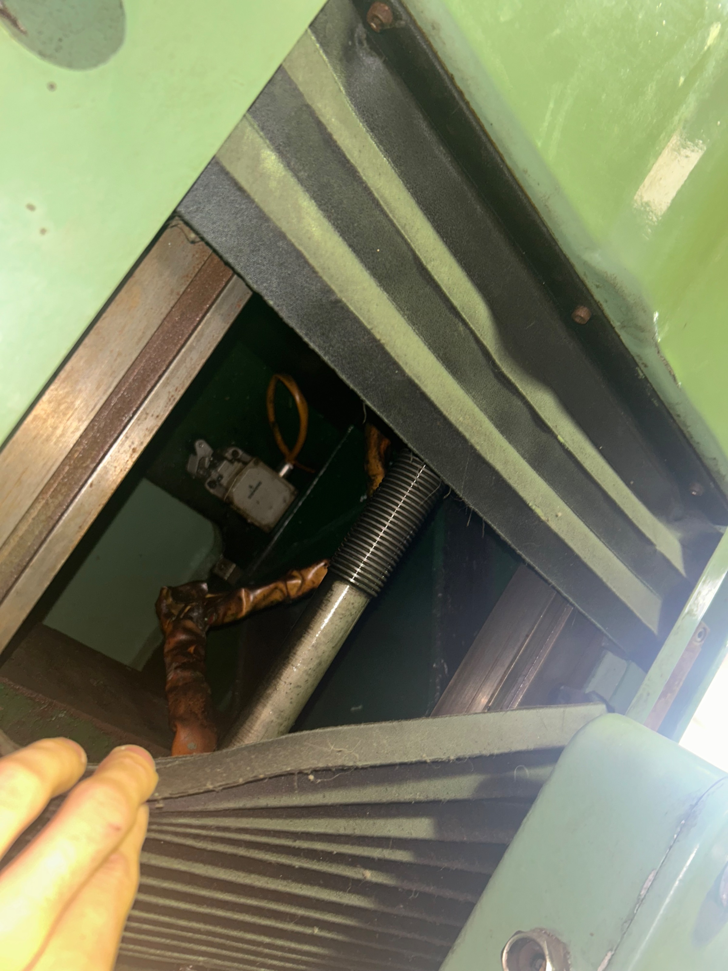

Hey thank you for your reply
Here are some pictures of the machine, apparently, and as it should, the Z and Y are ballscrews.
will be posting more info

does not look like a ball screw to me. More like a regular "ACME" srew?
