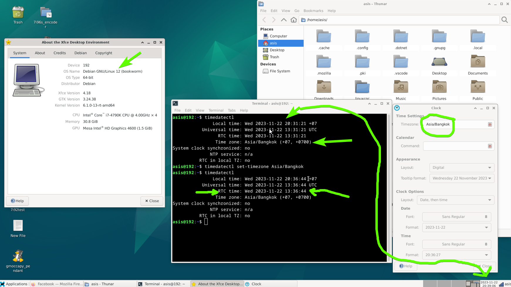

Hi
I use Debian12 from LinuxCNC_2.9.pre-amd64.hybrid.iso
I have problem to change Time
I use cmd
timedatectl set-timezone Asia/Bangkok
But, Time show on down right is local time 20:XX:XX
My location is Asia/Bangkok = 13:XX:XX
How to use time 13:XX:XX

I don't know if this helps, this solved my problem after reboot:
timedatectl set-local-rtc 1 --adjust-system-clock

This solution can help me, Thank you. ^^"
