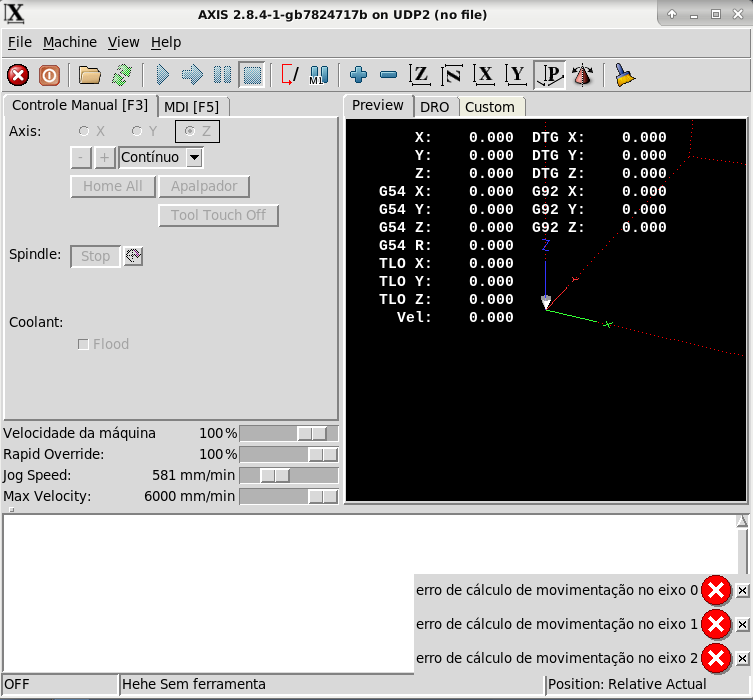

Okay thanks again, it wasnt just this, but after a few tries i managed to turn the machine on, but when i try to move one of the axis, the program shows an error like in the image
yeah i know the error is in portuguese, but it says "axis movement calculation error"
and it repeat for every axis
