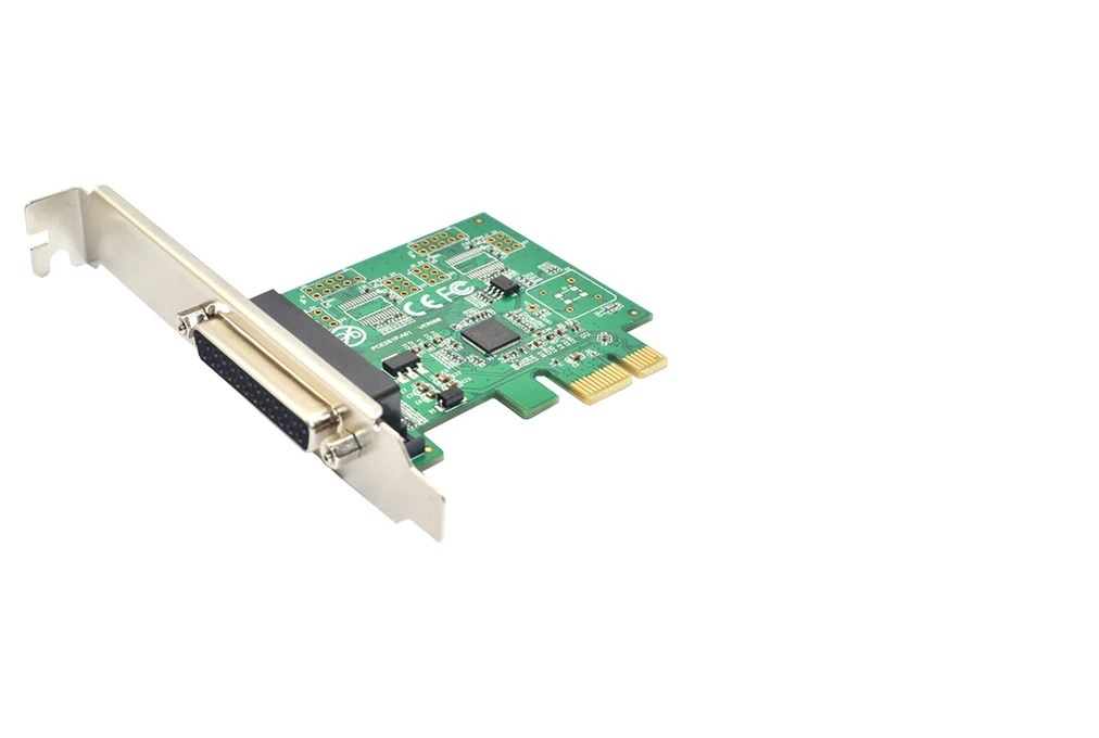

If your budget is the main concern, you might want to consider these? They are not a fast or high end solution, but they are not very costly
You will have to add your own wiring somehow, because they do not have screw terminals.
If you PC has card slots you can use more than one of them, I tried two (but I think more than two is also possible).
Greetings Timo
