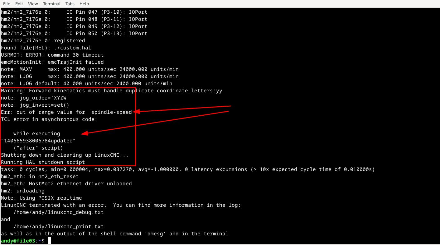

24 Dec 2023 18:48 #289016
by gardenweazel
Issue with RPS to RPM was created by gardenweazel

Replied by PCW on topic Issue with RPS to RPM
Not sure if this is the issue here but there is a missing
connection because the connection between LinuxCNCs
spindle speed command: spindle.0.speed-out-abs
and the signal spindle-vel-cmd-rpm-abs is commented out:
# net spindle-vel-cmd-rpm-abs <= spindle.0.speed-out-abs
This signal is used for setting the PID command:
net spindle-vel-cmd-rpm-abs => pid.s.command

24 Dec 2023 21:12 #289019
by gardenweazel
Replied by gardenweazel on topic Issue with RPS to RPM
I have this line: net spindle-vel-cmd-rpm-abs => pid.s.command
approximately 20 lines above this line: # net spindle-vel-cmd-rpm-abs <= spindle.0.speed-out-abs
Fusion 360 uses RPM and it looks as if Linuxcnc uses RPS.
I really need some way that I can use RPM in LinuxCNC if possible.
Or should I just divide the RPM settings in Fusion 360 by 60 and use that so that it matches LinuxCNC RPS?

24 Dec 2023 21:40 #289020
spindle.0.speed-out-abs is in RPM but is unconnected in your hal fileYou should uncomment this line to re-connect them:

09 Jan 2024 16:11 #290314
by gardenweazel
I did make this change.
