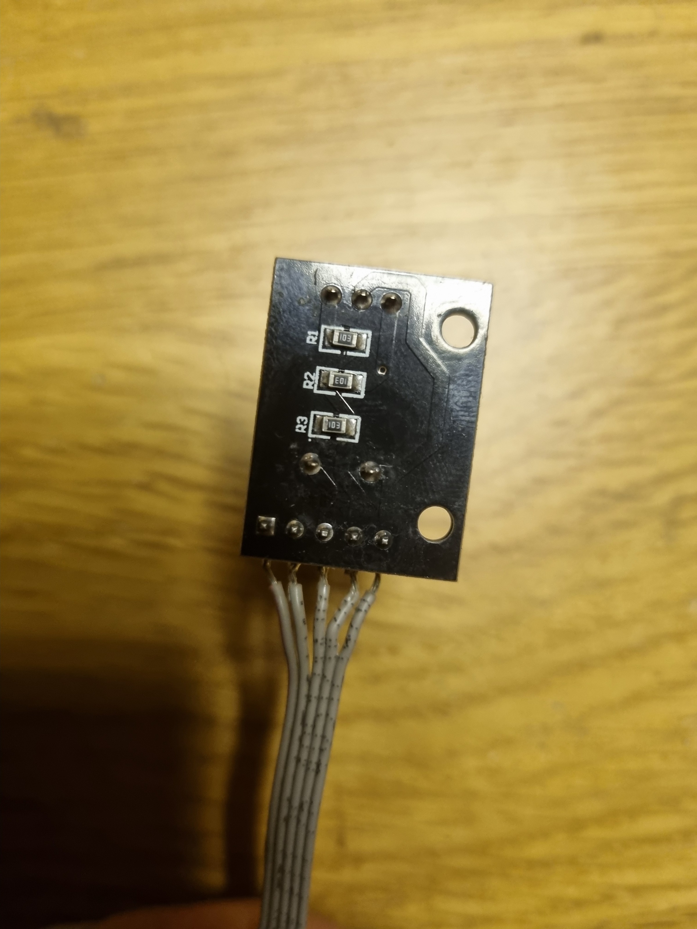

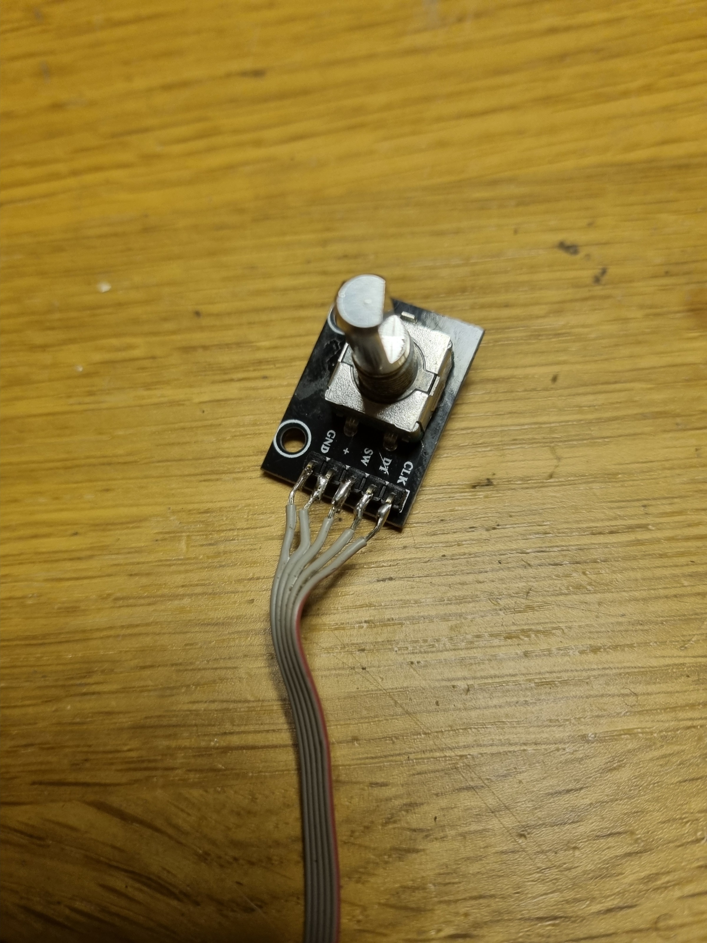

Replied by PCW on topic Rotary encoder for feed/spindel override wiring Meas 7i77
Does that device have a quadrature output?
It's not clear from the markings.

Replied by CNCDoc on topic Rotary encoder for feed/spindel override wiring Meas 7i77
Yes it is quadrature.
