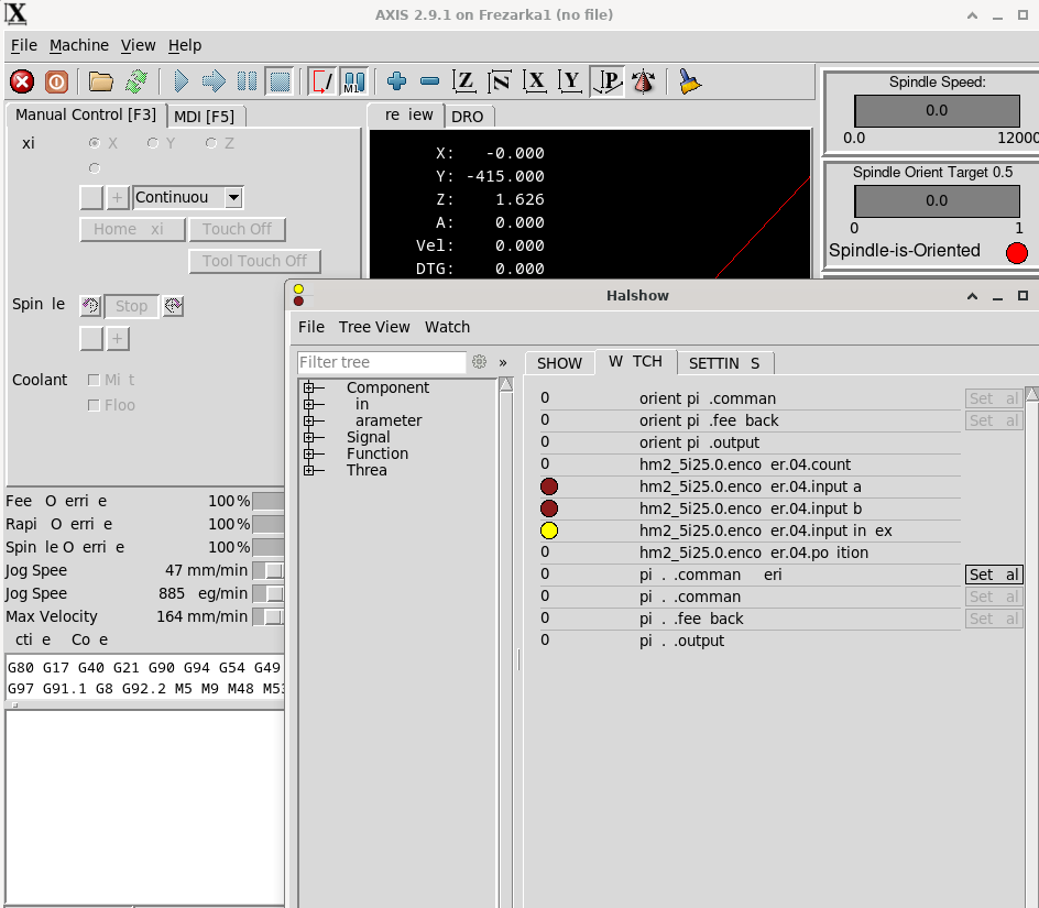

I have problem with linuxcnc 2.9.1
Sometimes after start linuxcnc axis dont show correctly words (tomorow go to insert scrennshot)
Sometimes when I try to do something for example open file, mouse cursor freeze, sometimes freeze and screen is black and worst off all freeze and back to login page.
Computer is dell optilex960 before working on linuxcnc 2.7 and 2.8.4 without problems.
Last what I install new is two usb 3m extensions and new cherry keyboard.

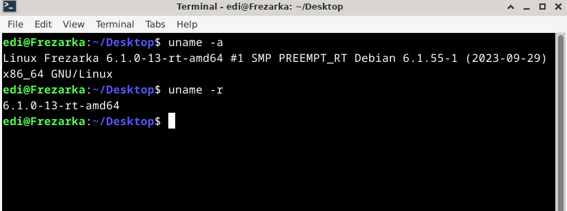

... you can share your SO and istallation? in teminal :
than
and post output here.
but with mint19.04 ...
uname -athan
uname -rand post output here.

I install everytime from here linuxcnc.org/downloads/
In video we see the problem. For example I cant homing two or more axis on the same time. Try to make for frezze and back to the login page but not lucky this time. But we see frezze couple times.
My current version LinuxCNC 2.9.1 Debian 12 Bookworm PREEMPT-RT ISO
