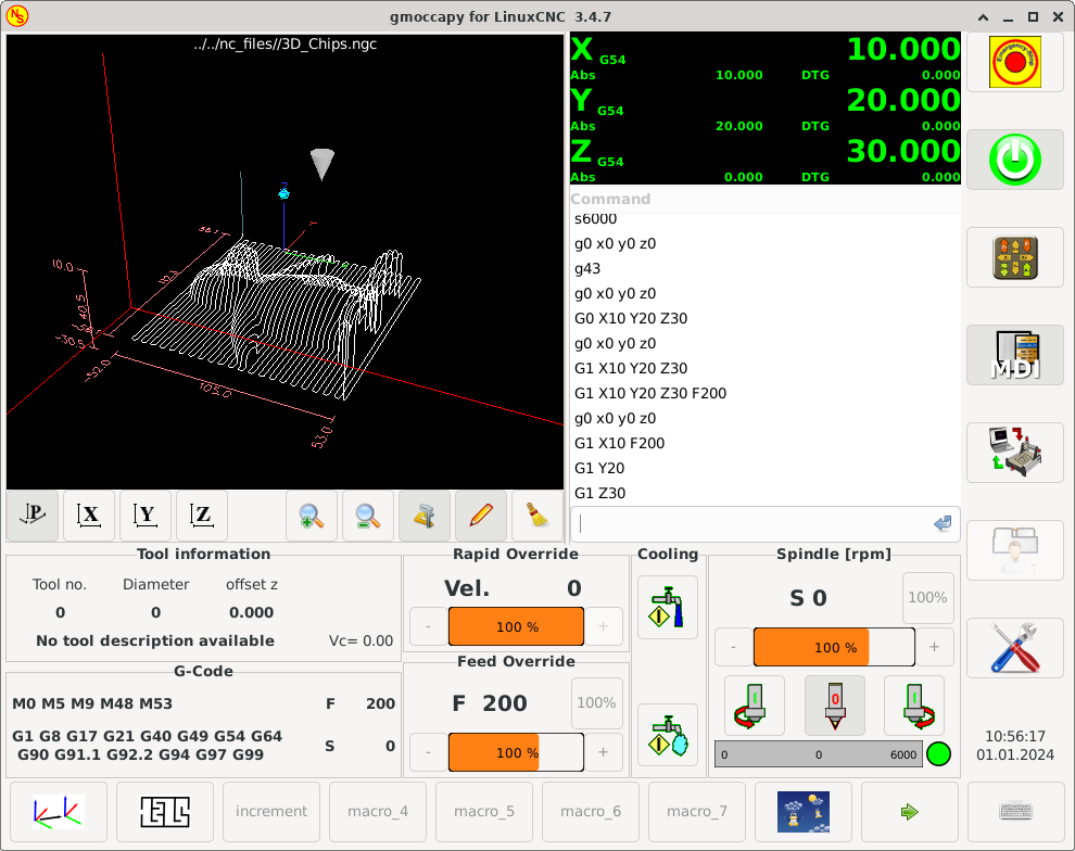

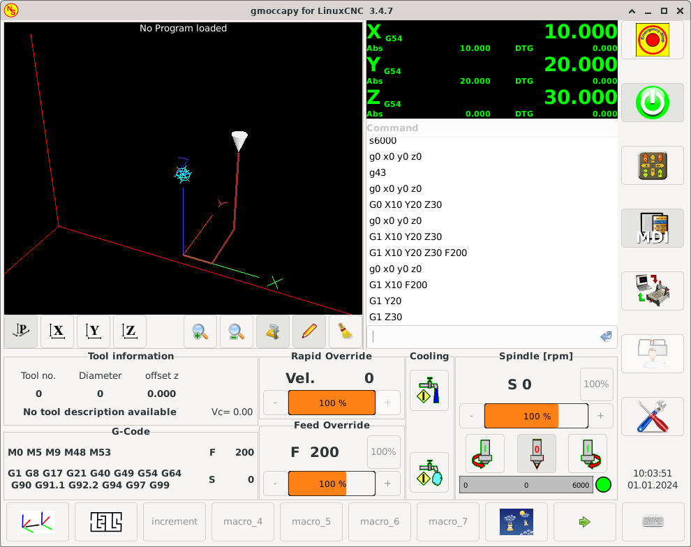

c.mdi("G1 X10 F200")
c.wait_complete()
c.mdi("G1 Y20")
c.wait_complete()
c.mdi("G1 Z30")
The start and end coordinates are the same, but the progression is completely different.

Gmoccapy doesnt run mdi commands in its python code, but in mdi Widgets
So wait_complete() in Gmoccapy doesnt wait for mdi commands started in mdi Widgets
Proof that it is:
github.com/LinuxCNC/linuxcnc/issues/2489

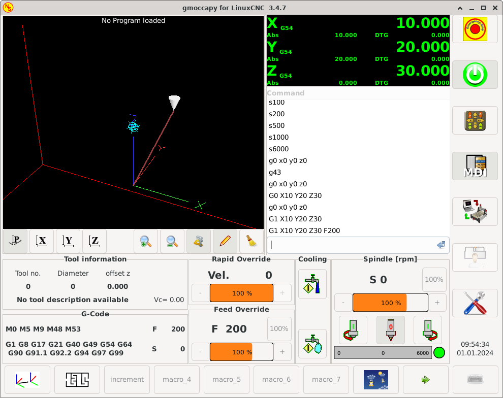

1) Starting Gmoccapy (Python Interfaces commands)
2) Waiting for operator
3) The operator starts HALUI MDI commands for move to some specific coordinates
4) Waiting for operator
5) Using MDI commands in widgets in Gmoccapy, the operator starts the spindle to warm up
6) Waiting for operator
7) Using MDI commands in widgets in Gmoccapy, the operator stops the spindle
8) Waiting for operator
9) The operator starts the program in AUTO mode
Here in this case there can be no problem, because everything happens gradually. A race condition cannot occur.
The problem arises when the G-code contains tool change commands.

c.mdi("G1 X10 Y20 Z30 F200")
This is Python Interface command
