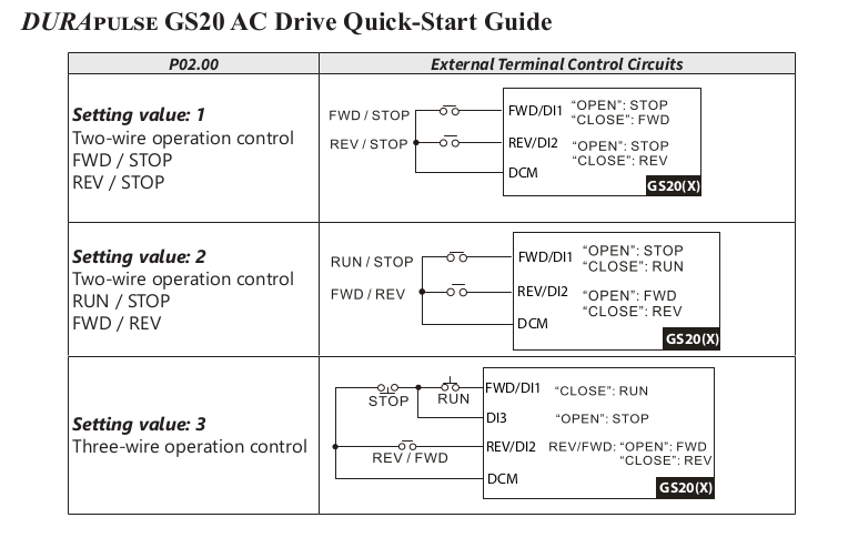

I just got a GS20 drive yesterday as a replacement for my mill but first I have to learn how to configure it for another project.

gsoft2 is great for config, I'm just using FOR and REV commands. I tried to work out the pulse train on the gs20, but it wants 24v pulses and the mesa hardware I have requires um more electronics skill then I have. I considered using the 15 preset frequency via the DI3-6, but got the analog out card working so I think just a basic PID will do all I need.

ya 00.21 for auto mode and 00.31 for hand/manual
