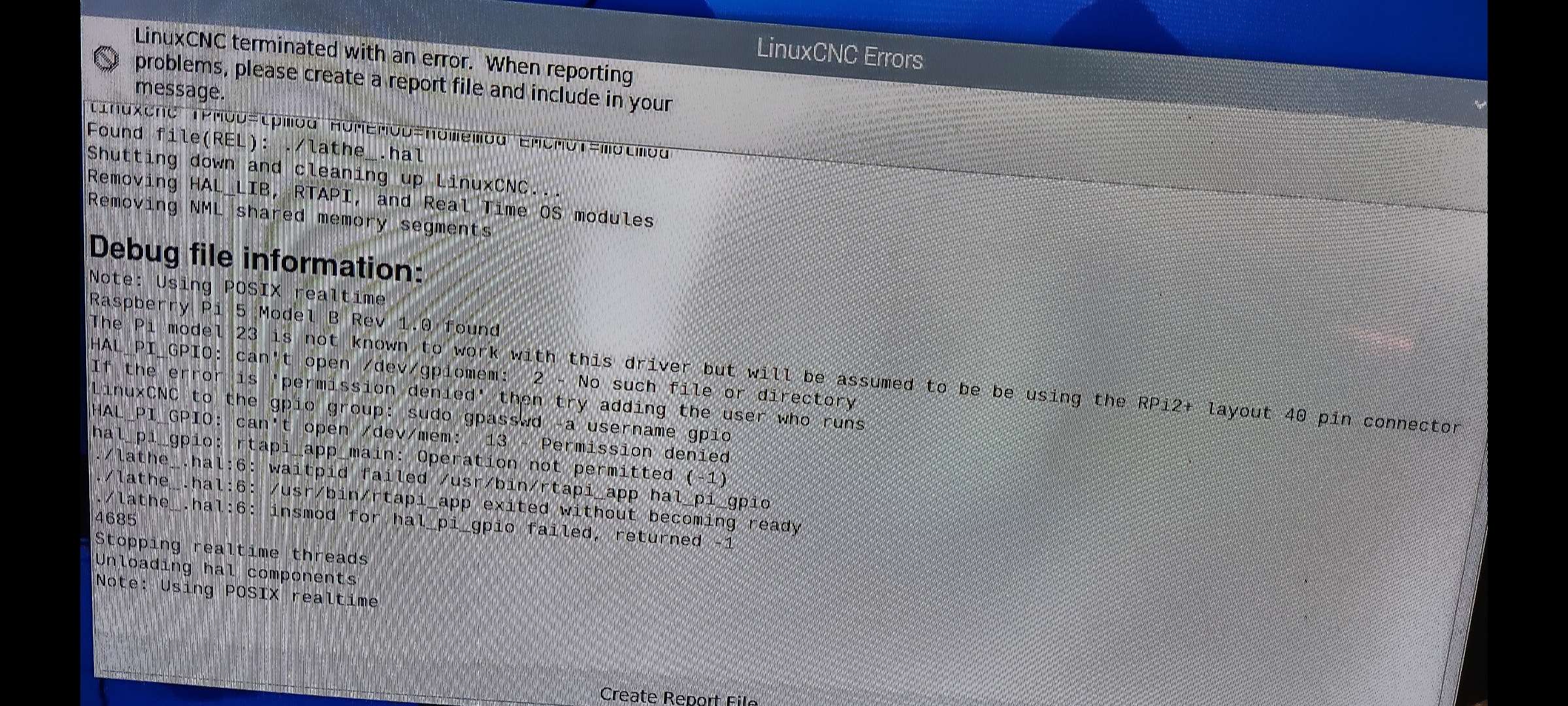

Raspberry pi 5
- rohit269
- Posts: 63
18 Jan 2024 07:17 - 18 Jan 2024 07:24 #290998
by rohit269
Raspberry pi 5 was created by rohit269
Last edit: 18 Jan 2024 07:24 by rohit269.

As per:
linuxcnc.org/docs/html/drivers/hal_pi_gpio.html
7. Known Bugs
At the moment (2023-07-16) this driver only seems to work on Raspbian as the generic Debian image does not set up the correct interfaces in /dev/gpiomem and restricts access to the /sys/mem interface.
7. Known Bugs

18 Jan 2024 12:48 #291019
by JT
Replied by JT on topic Raspberry pi 5
Don't use screen shots taken at a bad angle impossible to read. Copy and paste the text only.

- rohit269
- Posts: 63
18 Jan 2024 14:44 - 18 Jan 2024 14:59 #291034
by rohit269
Replied by rohit269 on topic Raspberry pi 5
Thanks for reply sir i am attached error please see
Last edit: 18 Jan 2024 14:59 by rohit269.
- Posts: 21901
- Thank you received: 7465
18 Jan 2024 19:38 #291056
trywhere username should be PI or whatever user name you are using.
Replied by tommylight on topic Raspberry pi 5
HAL_PI_GPIO: can't open /dev/gpiomem: 2 - No such file or directory
If the error is 'permission denied' then try adding the user who runs
LinuxCNC to the gpio group: sudo gpasswd -a username gpio
HAL_PI_GPIO: can't open /dev/mem: 13 - Permission denied
hal_pi_gpio: rtapi_app_main: Operation not permitted (-1)sudo gpasswd -a username gpioPlease Log in or Create an account to join the conversation.

19 Jan 2024 00:42 - 19 Jan 2024 00:44 #291078
by rohit269
Thanks for reply, sirI am already add user rohit to group gpio but same error show.
Last edit: 19 Jan 2024 00:44 by rohit269.

19 Jan 2024 06:35 #291094
Replied by Cant do this anymore bye all on topic Raspberry pi 5
The error is
/dev/gpiomem doesn't exist
A replied previously
So have will have to start with a Raspbian image, build & install a rt kernel and then build & install linuxcnc.
But just for completeness can you run
and report the result
ls -a /dev/*mem*and report the result

19 Jan 2024 14:39 #291119
by elovalvo
Replied by elovalvo on topic Raspberry pi 5
This problem was already known:
forum.linuxcnc.org/9-installing-linuxcnc...-pi-5?start=0#285243
My advice is to use this new module (hal_gpio) which, in addition to working on Pi 5, in my opinion is more versatile and easier to configure
For changes to be made to .hal files it may be useful to refer to this video
forum.linuxcnc.org/9-installing-linuxcnc...i-5?start=110#290838
