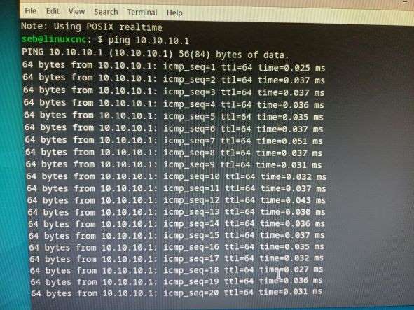

Ping 10.10.10.10
not 10.10.10.1, that is your PC.

21 Jan 2024 07:47 #291249
by seb88
Replied by seb88 on topic hm2 breaks connection

21 Jan 2024 08:02 #291250
Replied by tommylight on topic hm2 breaks connection
That is not very good, so try this

The ping times suggest that you have an Intel Ethernet chip on your
PC but have not disabled IRQ coalescing:
man hm2_eth
man hm2_eth
