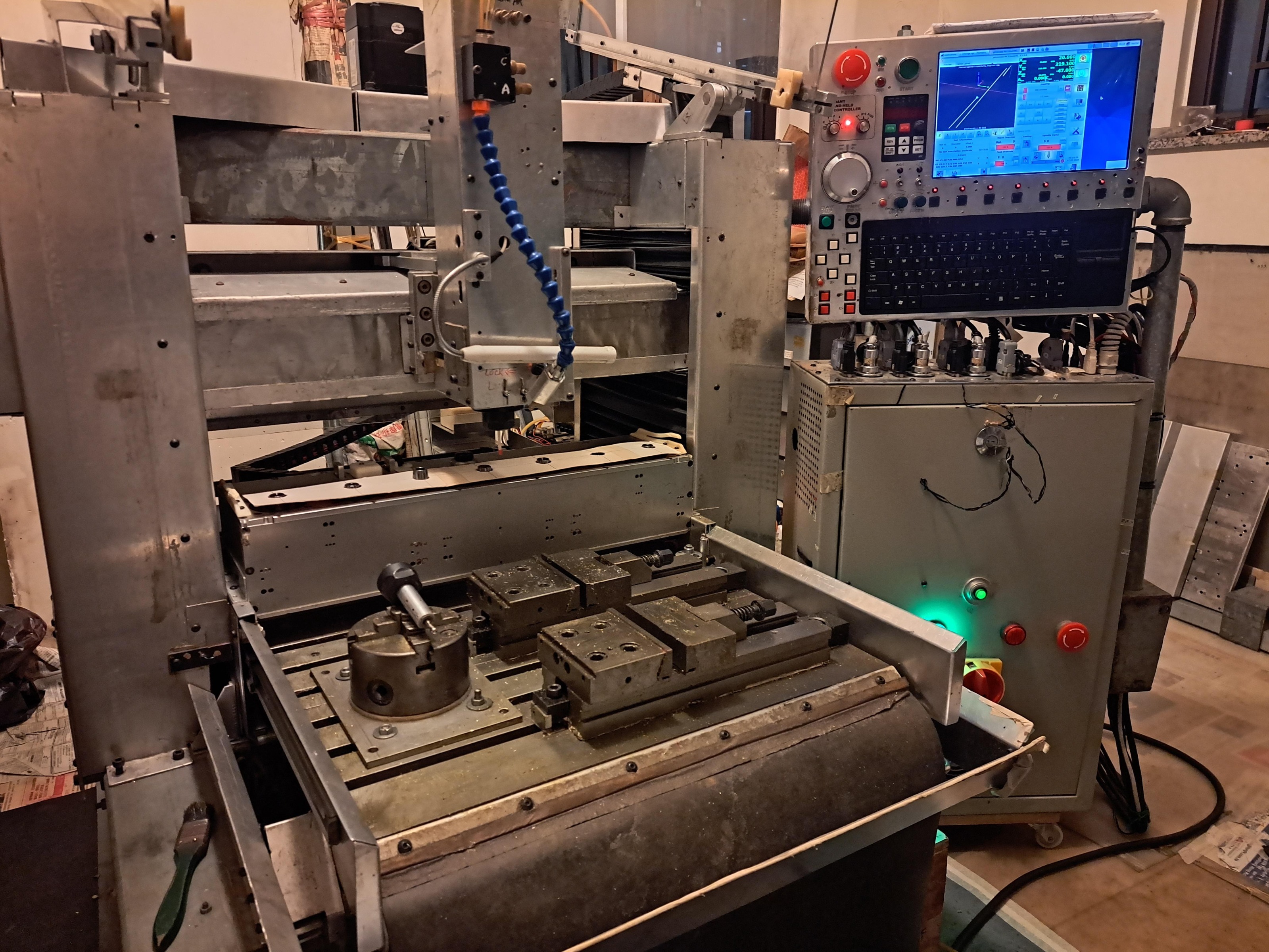

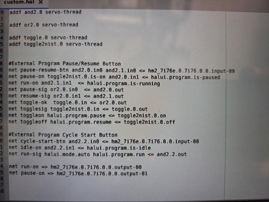

Lately, the machine always triggers itself to have cycle start, please see attached some photo. It uses 7i76e card, can anybody help? Also, what are the alert message meaning, they always comes out. I use LinuxCNC 3 years now, previously, I used Mach3 (more than ten years). In my feeling, It is difficult to use it than Mach3 !

more photos

Replied by spumco on topic cycle start, resume and pause problem
Just a guess without seeing your whole config, but I've had those messages when halui is calling an MDI command, and the MDI command is doing something not allowed. Or if the MDI command is mapped to an M-code that has a problem.
In your case there's something in the background - either from Gmoccapy or something you set up - that's trying to shift from auto mode to MDI mode.
To hunt it down, open halshow and see what signal/pins are connected to halui.mode.mdi. From that point you might be able to follow the logic back to whatever is causing an error.
Starting LCNC in a terminal and watching to see what happens before the error might be even more helpful. If 'halui.mode.mdi' is being called by Gmoccapy via a python message (or something similar), it may not be obvious in hal what's happening.

>Thanks for your help to remind me the use of halshow/halmeter in checking. It reveals that the real problem is not the newly added hardware button but are the existing 7 hardware buttons. But, it is still strange that, those existing buttons could work properly before the newly one added.
>Those buttons are for toolchaning use. The circumstance is that, from halmeter shows, during normal non-operating state, out of the existing 7 buttons, 5 are found at false states while 2 are at true states (strangely also, why they are not shown at the same states as true ). However, these help me to find out that, there is my errors. A long time ago, i made physical change in circuitry of the button keys by going no longer pulling up or "called active low", however, i didn't do the change the setting of (net toolchange-x halui.mdi-command-0x <= hm2_7i76e.0.gpio.0xx.in_not)
to (...hm2_7i76e.0.gpio.0xx.in)
>Furthermore, i found my toolchanging; o<change> program, has error too, one Oxxx number was used twice (in one more area)
>I haven't screen out(determine) which issue causes the problem mainly or more. And, after doing the corrections, the problem of "cycle start randomly" disappears and all goes well

>Attached are a photo of the my machine that showing the layout of control panel and buttons, also, the o<change> program files, just for better understanding.
