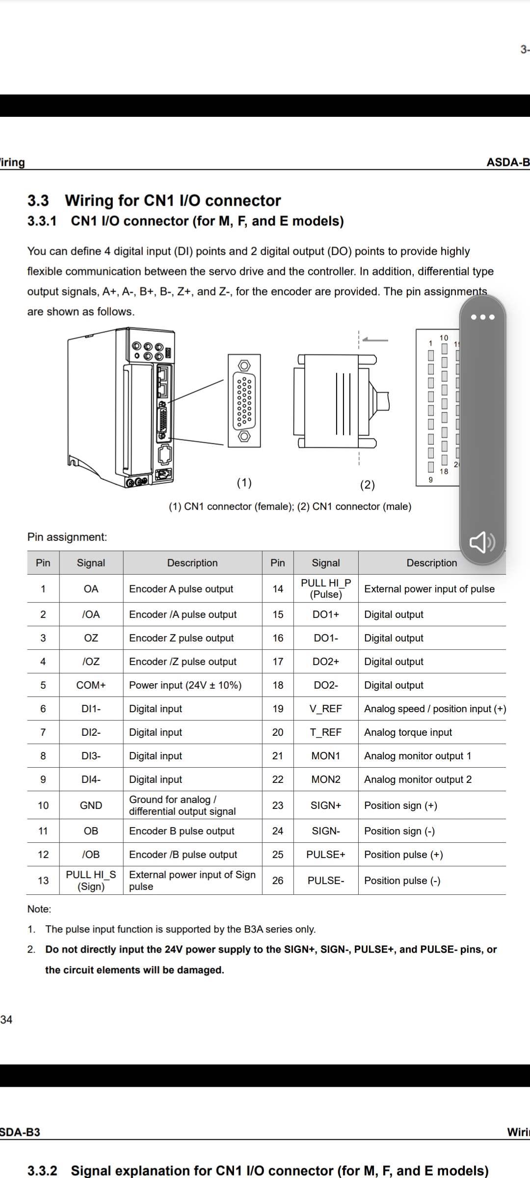

Hello guys, I'm currently in the process of completing a retrofit on my milling machine. I swapped the old motors for Delta B3 1kw servos. Now I want to connect them via step and direction signal, but I don't know where to start and I don't know anything about it. I can't figure it out from the instructions either. Can someone help me? I use a Mesa 7i96s to control it

Which pins are absolutely required or can I set this via the parameters?

The minimum for a step/dir setup would be:
SIGN+ 7I96_DIR+
SIGN- 7I96_DIR+
PULSE+ 7I96_STEP+
PULSE- 7I96_STEP-
If one of the digital inputs can be programmed as ENABLE
and driven by a 7I96 output, That's probably better

I'm using a Mesa 7i96S on my mill with Delta B3 servos. I've posted complete schematics in this thread:
forum.linuxcnc.org/12-milling/50559-opti...mh50v-cnc-conversion

I would like to thank you in advance for your help. Cables are already soldered according to your plan, but I don't quite understand the parameterization of the power amplifier. Could you help me or send me yours?

I started with the quick guide from here.
Is for the B2 controller but I think should work for B3 too.
www.damencnc.com/userdata/file/ASDA-B2_Quick_Start_Guide.pdf

In the end I didn't change many at all, basically only the mapping of some output and input pins and the number of steps per revolutions (egear).
Replied by Unlogic on topic How do I connect the Mesa 7i96s to Delta B3 servos
The B3 drives have a large amount of parameters available. At least it felt like that for a rookie like me. In the end I sat down and went through the list of available parameters in the manual and tried filter out which ones that applied to my setup.I would like to thank you in advance for your help. Cables are already soldered according to your plan, but I don't quite understand the parameterization of the power amplifier. Could you help me or send me yours?
