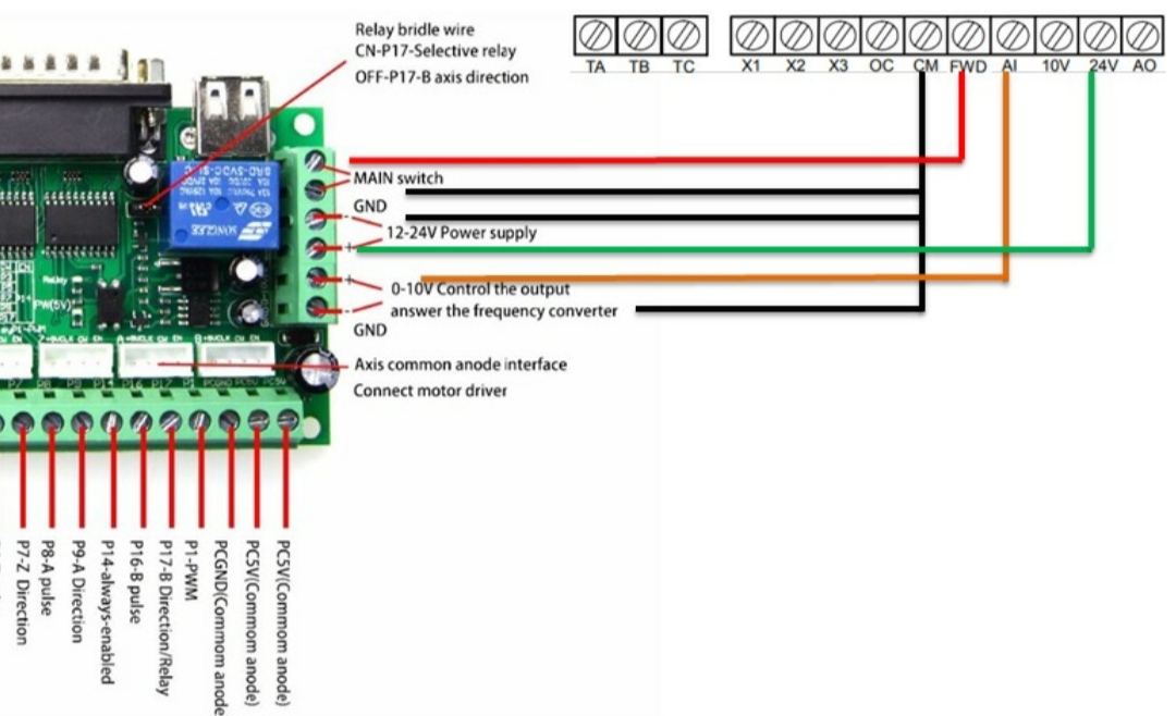

Hello, I'm not sure what's going on with my spindle setting. I'm using the 7i92t with 7i92_5abobx2d.bit and a cheap 5 axis bob with spindle output set to i/o 000: for pin 1. The relay pin 17 is working as expected but I get 10v on pin 1 with the relay off and no voltage with it on. Giving S commands has no effect with relay off or on. My spindle setting from pncconf were[SPINDLE_0]

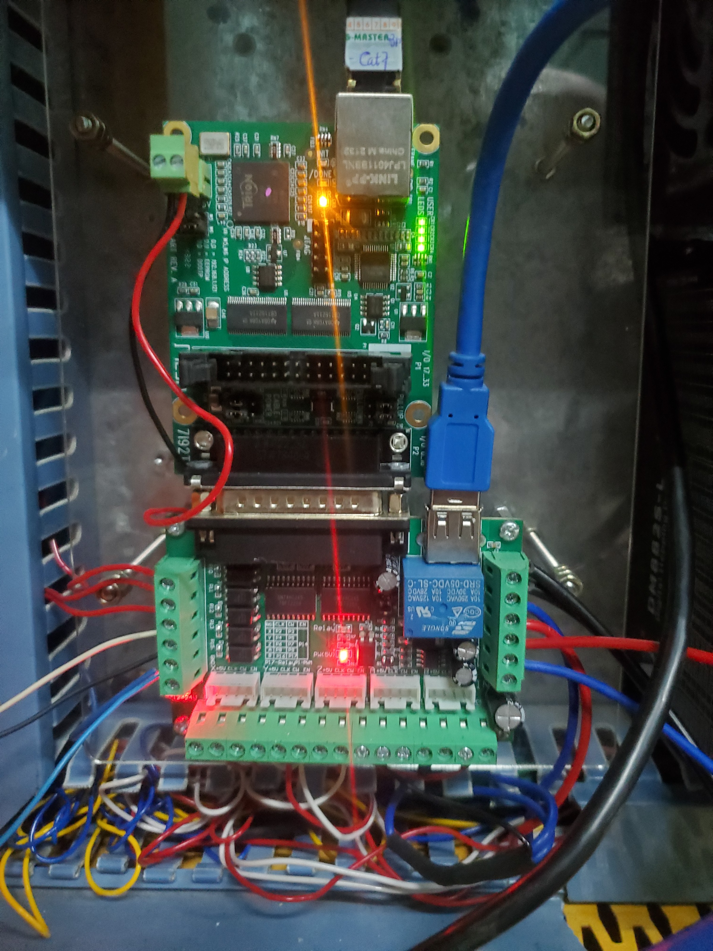

Upload here a picture of the BOB, we have several members here that know all the ins and outs of BOB's just from a picture.

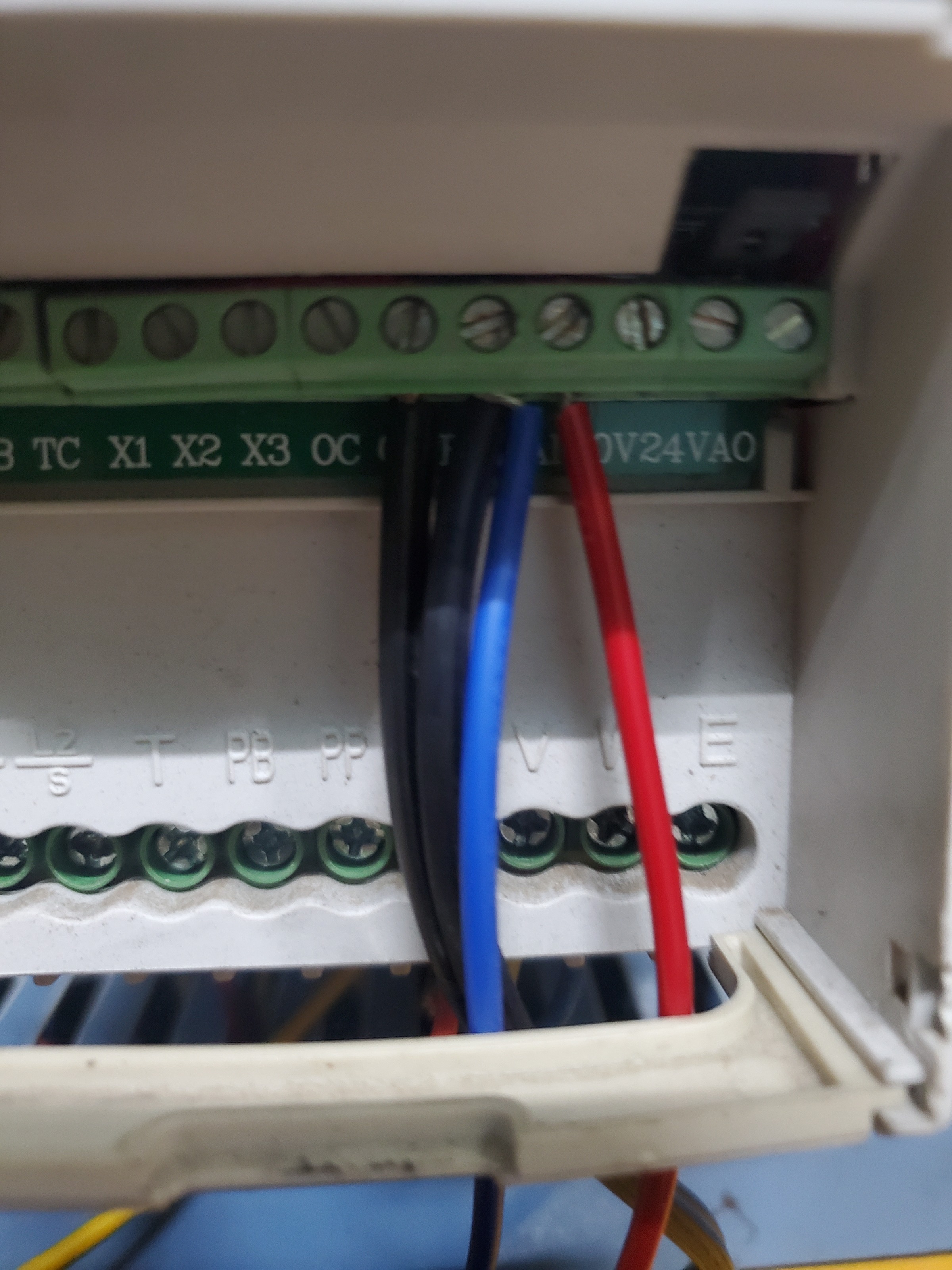

I don't think it's a wiring issue as I was first testing with a multimeder from pin 1 to gnd.
The spindle starts running when the relay is off. So that's a problem. I need to invert that in the sunfar e300 vfd or in hal somehow.
But after using a M3 I can not change the voltage with a S command. After using a M5 command I can not change the voltage as I don't think should be able to. If I disconnect the fwd wire from the vfd it will get 10v when I use a M5 command and 0V with M3 regardless if I use S0 S12000 S24000.

I have it connected the same as in this diagram.
