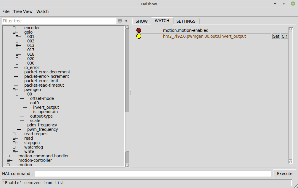

Replied by PCW on topic 7i92t and 5 axis bob no 0-10v on spindle
Pncconf works for me that is it creates a working spindle configuration
The only thing it will not do is the inversion of the PWM output which
requires the:
setp hm2_7i92.0.pwmgen.00.out0.invert_output true
requires the:

by 0jw
Replied by 0jw on topic 7i92t and 5 axis bob no 0-10v on spindle
It works now! that was absolutely the problem. thank you PCW for your help!
Yes, the 0-10V on the 5ABOB is controlled by PWM.
PWMgen 0 is routed to P2 pin 1 on the 7I92 5ABOB firmware
